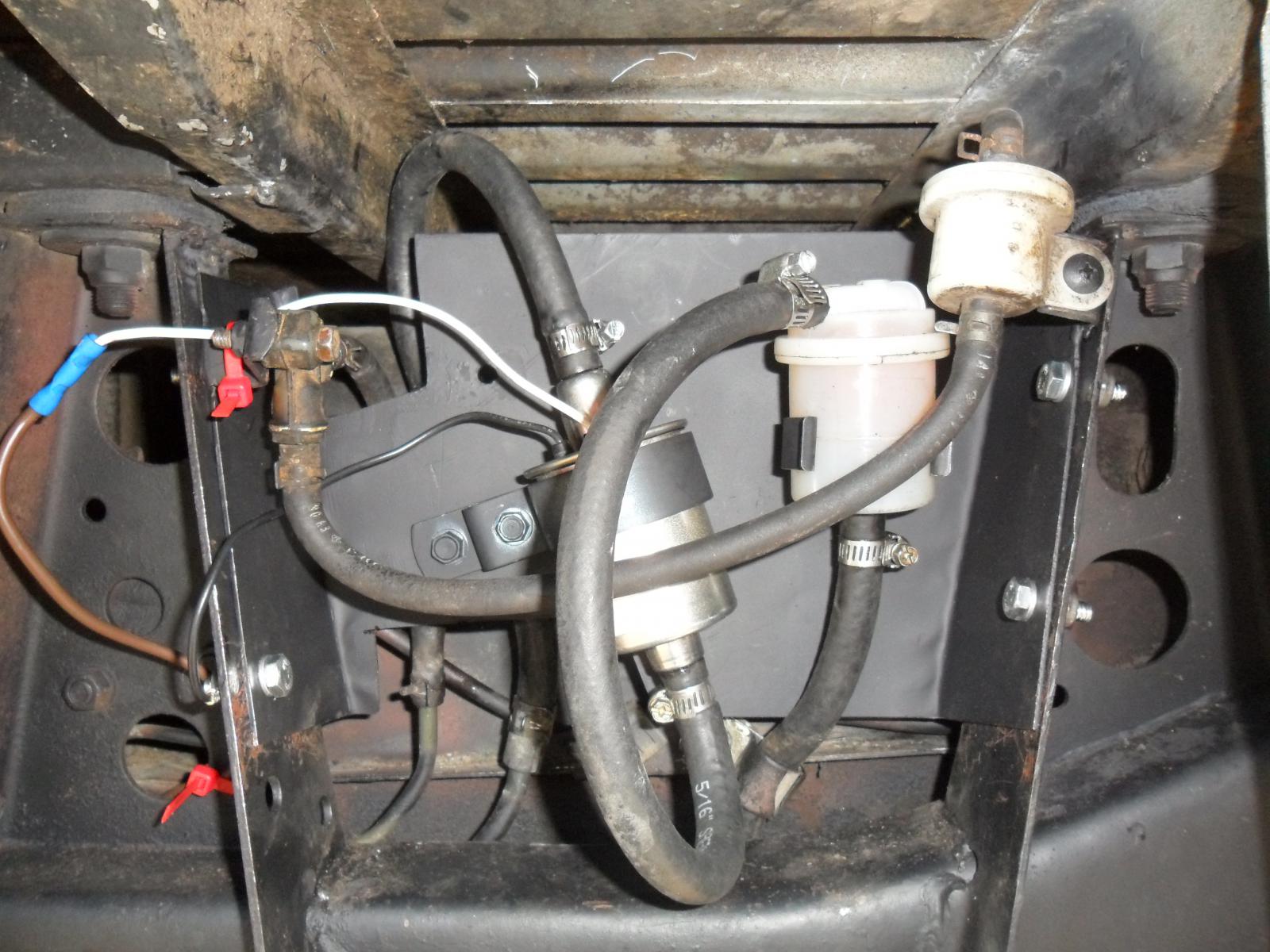

    Here is how I mounted mine in front of the tank under the skirt driver side. I used 1/8 sheet metal saved the OE mounts and added them some welding involved. Make sure your gas is low when you do it. I plugged the return line where the hard line ends up in the engine bay. I used a gas rated hose that I plugged with a bolt after a silicon cap melted.

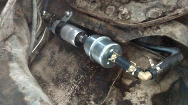

    And FWIW here's how I mounted my Carter pump to the brace along the front of the fuel tank on my longbed:
