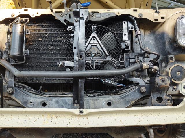

    Also I recently went on a search to find a good fan to help the AC condenser at idle and low speed. I wanted a fan that was not aftermarket so if I needed to replace the motor or something, I would be able to easily find a replacement. after roaming around the junkyard, I found a 93' Toyota with a condenser fan that looked like it would fit the bill perfectly! It appears to be used in pickups and 4runners from the mid to late 80s through to the mid 90s and is readily available still as an assembly or even just the motor itself for around $40. I also like that it uses a round shroud to minimize the amount of surface area blocked when the fan is off. the shroud is also made out of metal, perfect for cutting and welding to for mounting!

    Next post ill show how I mounted the fan and How I control it!
