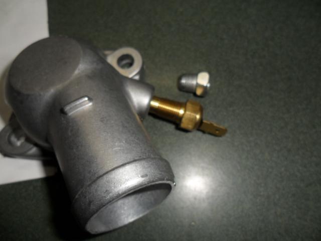

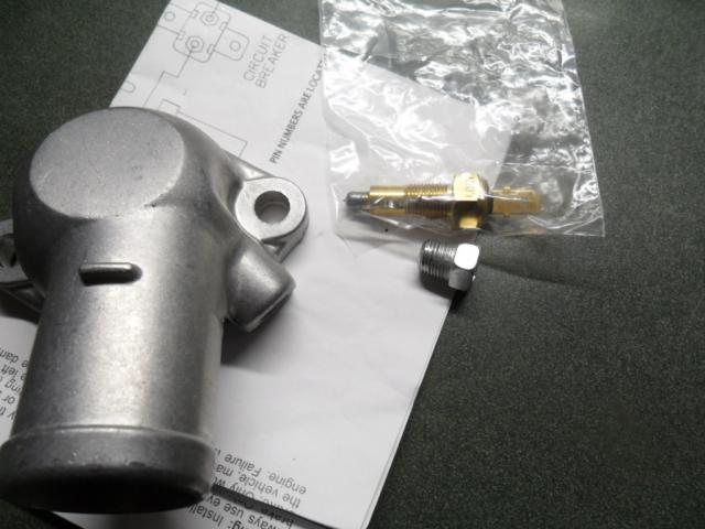

    I received the wiring kit and the 1/8 npt sensor does not fit in the threaded hole in the housing from that link.
    Anyone know what size that threaded hole is? part #MD061791
    So far have not found specs on it. Added opic to show how far the 1/8npt sensor will go in for reference. That plug is what I took out of the hole and it was only a few threads in.
    Over on DSM Tuners (Diamond Star Motors) they tell me it is 1/8 British Standard Pipe Taper. It definitely tapers.
    1/8 NPT will have 27 threads per inch.
    1/8 BSP or BSPT will have 28 threads per inch.

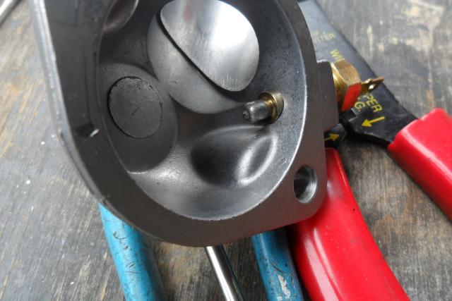

    Maybe I am not understanding you?? I have seen the adapters. they would have the same problem of not allowing the sensor into them far enough to thread. Here is another pic to show the rest of that sensor. I never thought about it but the two pin and single pin temp sensors in the block looked like just regular NPT when I replaced them years ago.
    EDIT- I have it apart got two new bolts for the housing. The old ones were thin at the top? I may have to shorten them a mm or two. IDK the size it was one of those places where a counter person takes your order or the bolt you brought in and gets your stuff. I didn't ask.
    The Tstat is 180 and in good shape. If I still have a heat issue then it will have to be the rebuilt head I purchased from some guy back east who is out of business or possibly the intake is somehow clogged up. So I am probably just going to drill and tap it. I haven't committed to that yet but it looks like it is going that way.

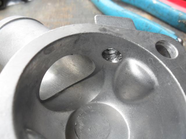

    It turned out to be very simple. I put it in the vise. got the 21/64 bit and it didn't even touch the threads it just cut the shoulder the manufacturing process left at the bottom of the hole. Then I ran a 1/8NPT tap into it far enough that when I screwed the switch in it was just far enough for the tip to be in the flow.
    here is the housing with the shoulder drilled off, the smooth spot and with the sensor screwed in loosely.
