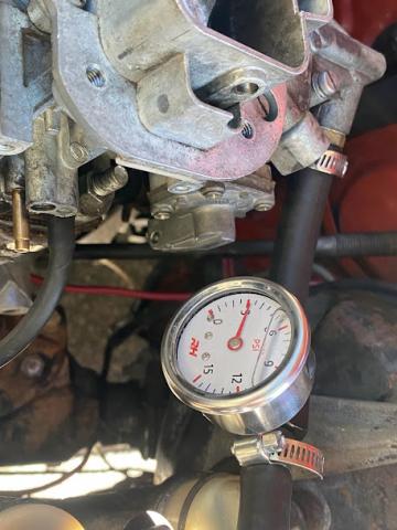

    I believe I have weak spark/dead ICM. Fuel pressure is great, new pump, holley regulator, clean genuine weber 32/36, pressure set smack at 3.1PSI. Timing didn't jump because every once and awhile it will crank to life, maybe it'll idle and then act like it floods out, or other times you can rev it up but when it comes back down to idle it back fires and dies taking quite a bit of effort to get it to restart.

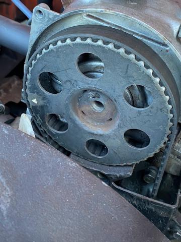

    Three months after the original post, I've finally pinned down what my intermittent run issue. My truck decided it wanted to have VVT! Now the trouble is actually trying to source the cam gear. If anyone has a 4G63B 2.0 Cam gear I've got paypal/cashapp/venmo ready to go.

    I wonder if this one would fit it's from a newer G63B? I belive but when I get the chance I will look threw the parts engines I have and see if I have a spare that's usable but I have also heard they make a adjustable cam gear for our engines but I've yet to find one unless someone else here knows of a alternative.

    I dont think that one is correct.. in my opinion its way over priced.. its from greece so it will take along time to ship and if incorrect part it would be hell to return... plus the post says crankshaft gear... its a camshaft gear.. plus to me the FR written on it means front right which indicates 2 gears this being the right side... I could be wrong.. but this is just my opinion on that post..

    Well I dug more and more ran some part numbers found this site https://www.mitsubishipartswarehouse...w0LWdhcw%3D%3D looks like any cam gear.from a 1.5,1.6,1.8,2.0,2.4 will bolt up being OTR driving I can't just order a bunch and try atm but.you can find adjustable cam gears for other SOHC 2.4,1.5,1.8 engines for pretty cheap on cheapbay might be worth looking into.
