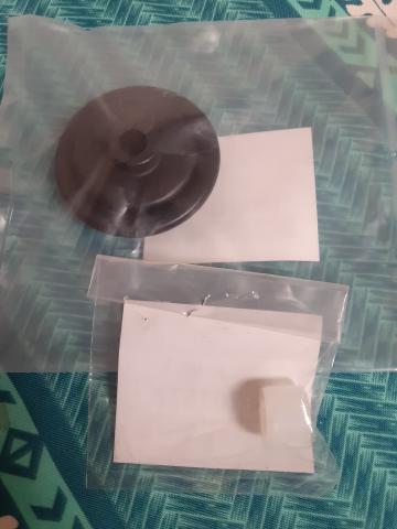

    I took out a part from the rear seal cover and I don't remember how it went back together. What is it and how does it go back together. Here is a picture of the part in question:
    Also, where do I get those rubber manual transmission shift boots for the km-145 manual transmission? Mines are cracked and leaking tranny oil. Here is a picture of my transmission shift boots. Where do I get the white plastic thing that goes on the end of the "shifter ball"?

    I bought these ones. They also have the white bushing you are looking for.

    My parts book lists different P/Ns for the two boots. The boot for the transfer case shift is MD704149. The one for the 5-sp trans shift is MD703619. Both are available from Amamaya and other sources.
