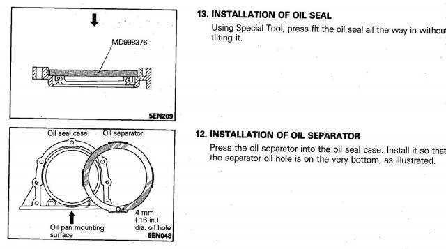

I took out a part from the rear seal cover and I don't remember how it went back together. What is it and how does it go back together. Here is a picture of the part in question:
