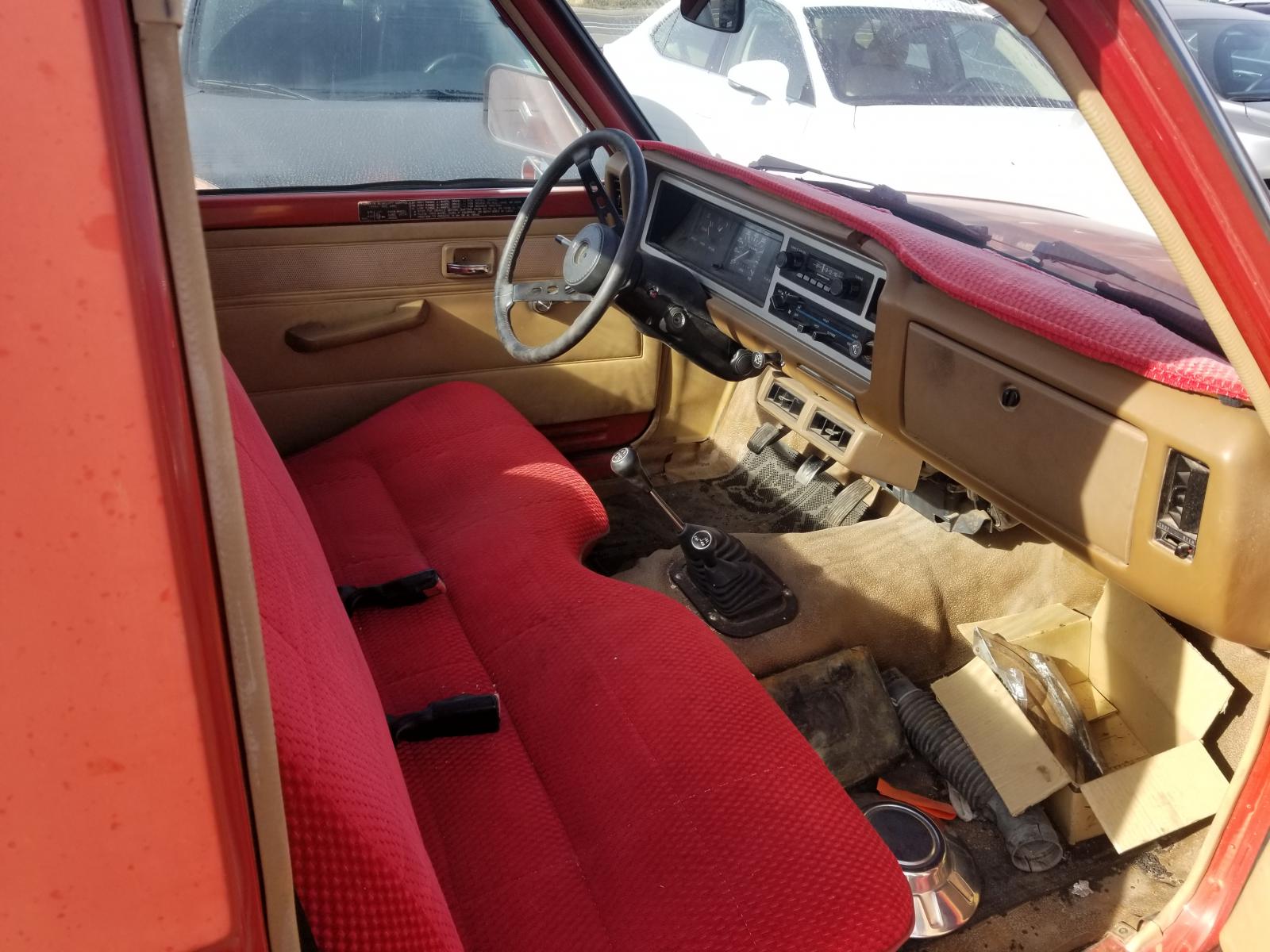

    Some pics...
    I know a picture tells a thousand lies but it doesn't look that bad at all. The red interior patch up is loud lol. From what you've described the rust is fairly typical of a Gen 1 and shouldn't be that bigger ordeal to fix as long as there isn't something really bad hidden under the floor or in the frame.

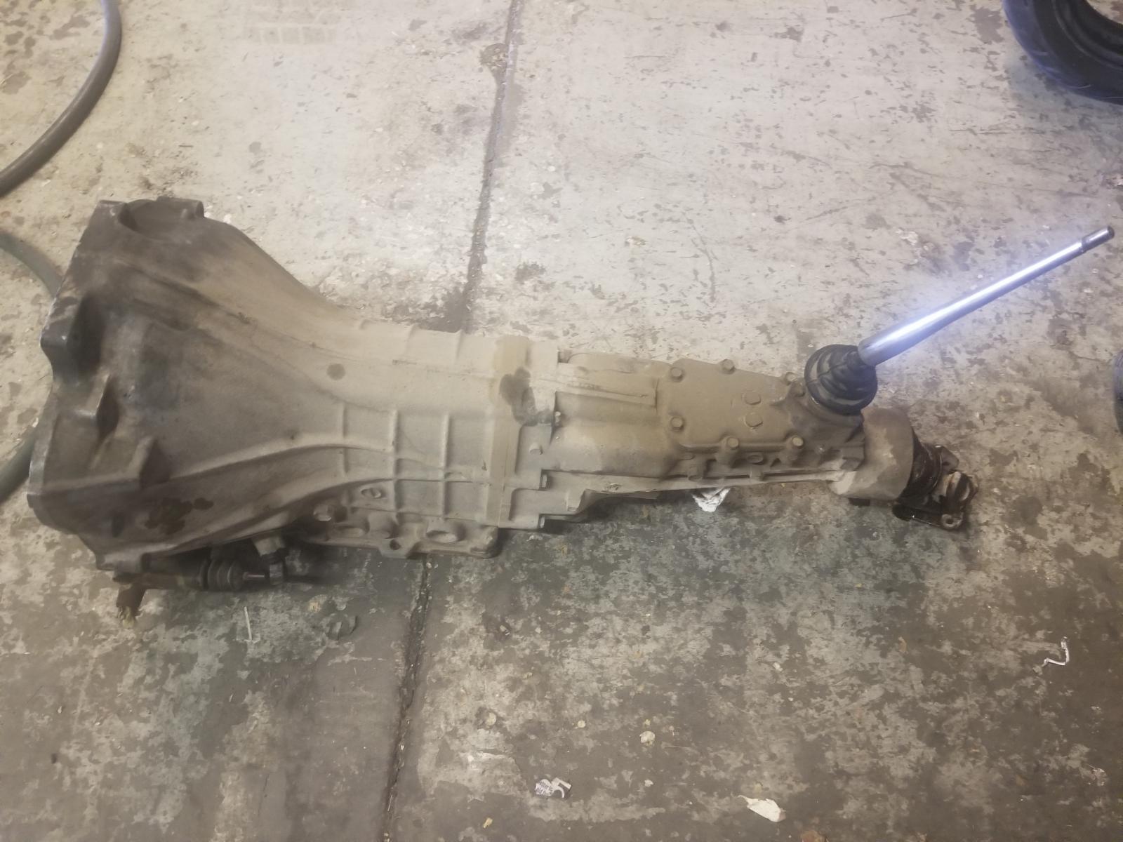

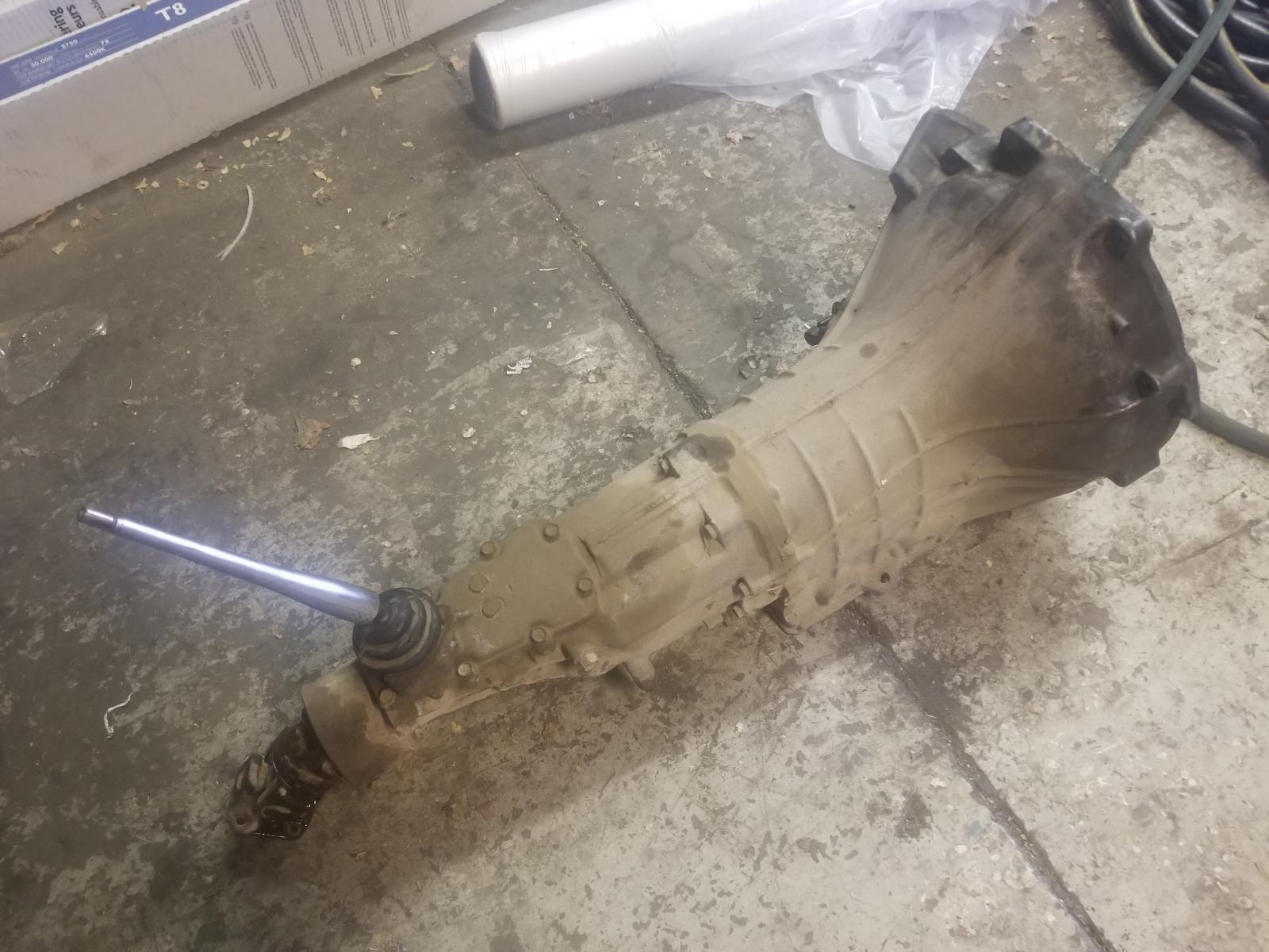

    I will take some better pictures tomorrow. Okay next big question.
    Onto the transmission. Can I theoretically use the cable clutch transmission, or will i need to use a hydraulic transmission?
    I have this extra one, but I am unsure of its internals like the original cable trans.
    Would I just swap tailshaft sections for my 4wd set up? Josh

    So, it has been a few days into the swap, and there are a couple small problems, mainly being that my hydraulic clutch transmission is 2wd, and I need a 4x4 set up.
    Hopefully someone can help me understand that I might be able to swap over the internals from my 4wd cable clutch transmission, to the 2wd hydraulic transmission to get the right set up??
    This would solve 99% of my problems considering the PO used a set up that I dont want to try.
    I am likely going to use the LSD out of my 2nd gen auto truck. Both are 3.909, and I would rather have it with a manual 5 speed.
    Please feel free to let me know your thoughts? After reading the thread on KM132 and KM145 differences, I might be confused a bit. Thanks, Josh

    I took the 2wd hydraulic clutch transmission, and the 4wd cable clutch KM145 transmission to see if the shop can make 1 good transmission that I need.
    Not too sure that they can use the hydraulic transmission case and swap the KM145 gears over.
    We'll see in the next few days I suppose. Josh

    I wish I could help you with the transmission question. I know the innards are the same on the wide and narrow block for the two wheel drive, but not sure what is happening with the 4x4 transmission. Let us know your results.
    The hydraulic swap I did with an existing transmission, so I just took the mechanical clutch from a 1st generation gas truck and installed a hydraulic clutch in it. It by far was the worst part of the entire build. Getting the clutch in there and lined up properly was a real pain in the rear. I used a hole saw drill bit and then tapped a dent where the bolt holes go through for the master cylinder. So far its held up just fine without any flexing or cracking.

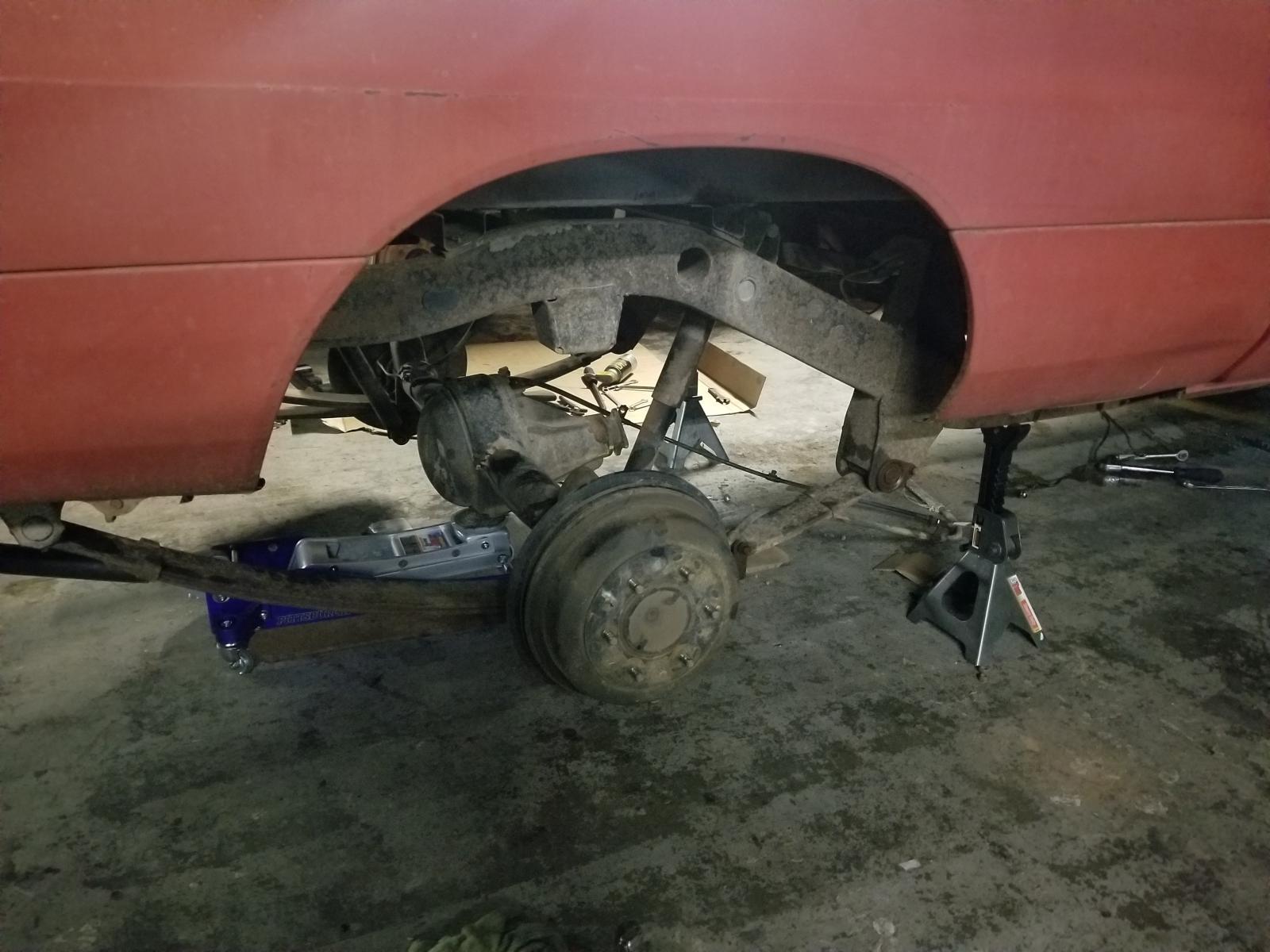

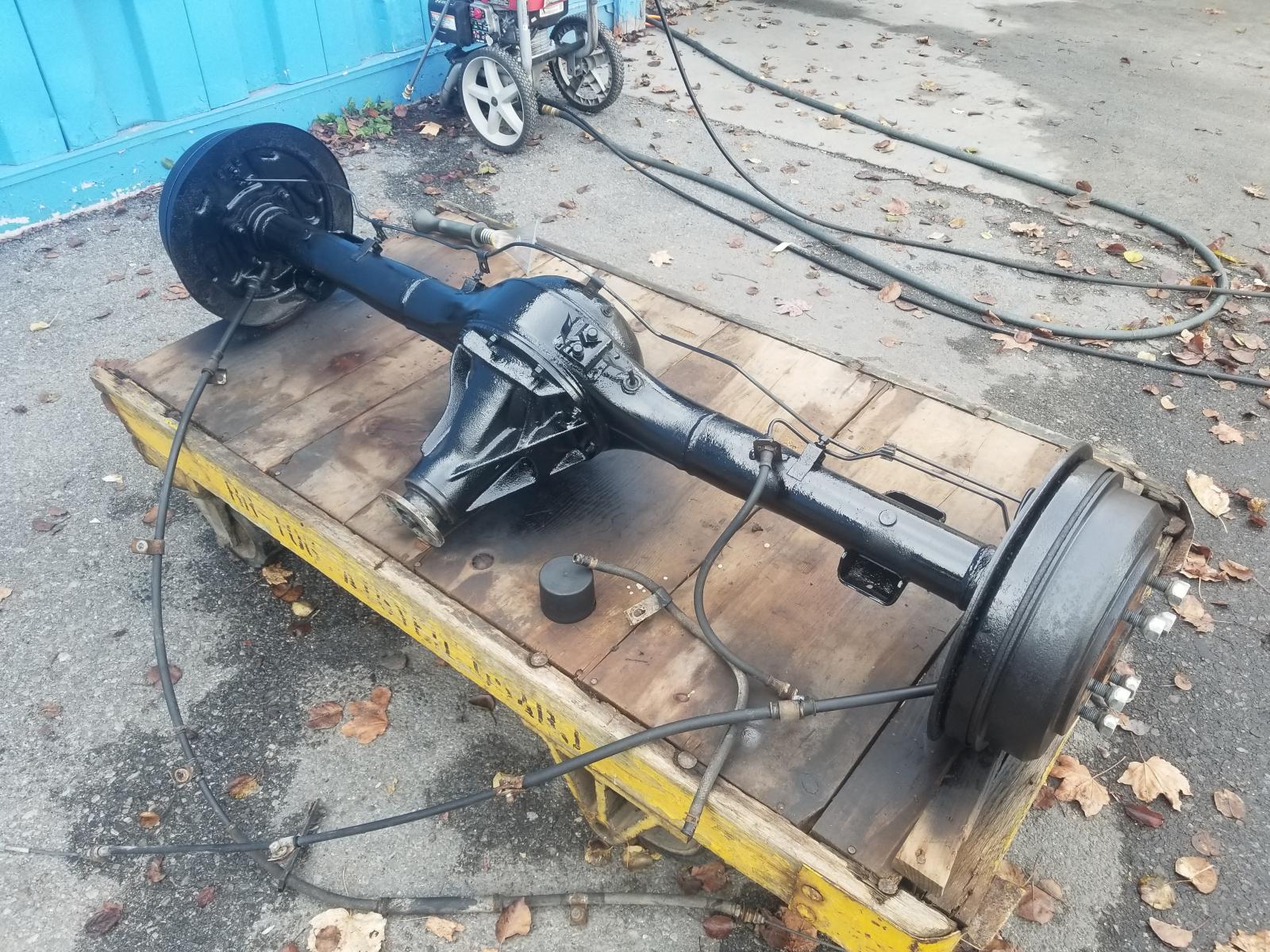

    Wow. Rusty suspension parts are just fighting me until the end. I finally got the rear end out, but the leaf bolts are just damn near seized.
    The rear end looked like it had about 30 years of oil, and dirt mixed in. It must have taken hours just getting it remotely clean.
    Tomorrow I will get everything cleaned up, and painted. It definitely could use a reseal while i am around there.
    Things seem to be coming along pretty slow. Perhaps it is because I am trying to get winter ready, really fast. Josh

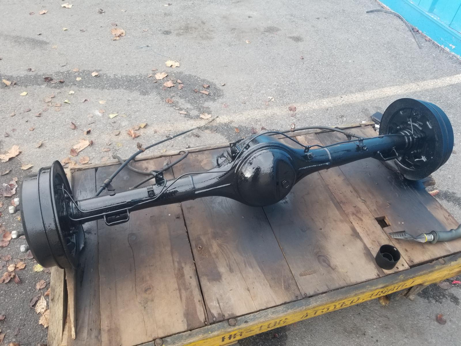

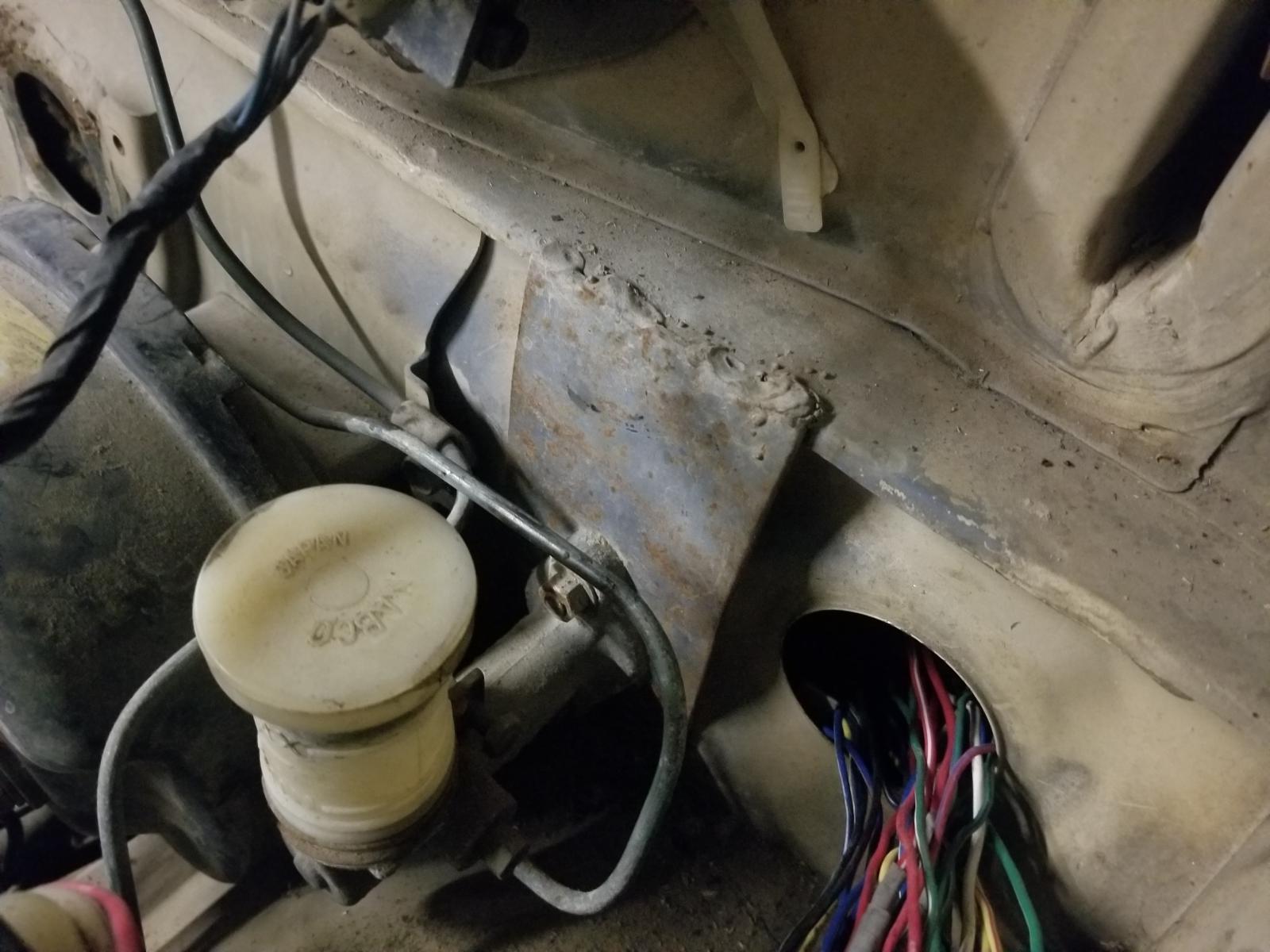

    Pics... Also, pics for the hydraulic setup. As always, pardon the lighting.
    Suspension parts get pretty crusty. I'll be investing in a media blaster off ebay when I can. Something that can handle sand, beads and soda would be the ticket. I gotta know - what is that duct running through the steering column mount? I'm trying to rig up 4 way A/C in my Gen 1 but ducting everything from the blower case is proving to be a challenge...

    Quote Originally Posted by mowgli5555 View Post
    I'd just cut those welds that the master cylinder is attached to and then transfer it directly over to the new pick-up. The pedal I used an air chisel to detach the bracket where it had been spot welded and then welded it into the new truck. In your case, they have already manufactured a nice strong bracket, so I'd try to recycle that as well.

    So yesterday was a rollercoaster day. I was almost finished derusting the LSD rear end, and forgot I had taken my glasses off for 10 seconds.
    Needless to say, I caught a shard of metal into my eyeball, and had to make a trip to the eye guy. Learned a valuabke lesson yesterday.
    Today I will finish a few things up, then I am starting the hydraulic removal, and set up.
    The transmission shop said the transmission would be ready tomorrow, but I will continue to cross my fingers.
    Having a hydraulic clutch, 4x4 turbo diesel small truck is exaxtly what I am looking for.
    Also, I went with the Bilstein B6 4600 series rears, so we'll see how they work out. Josh

    Okay.....Back to work. So I got the hydraulic set up out of the truck, but still am working on cutting the brackets out.
    It is a very tight spot, and I will have to be more creative to cut them out well.
    The leaf springs have officially done me in. Am I just going to have to cut the bolts off?
    I worry that I wont be able to find the first gen bolt set up for my truck. The bolt looks like it fits the bracket perfectly, and doesnt look the the 2nd gen bolt/washer set up.
    Also, the rear shackles look pretty bad, is there a replacement for them??
    I just want to finish the rear end and move on to other things. Josh

    If you can get the one side off of the shackle - take a drill with a 1/4 inch bit and drill the bushing and then run it around the hole until the bushing lets go of the bolt.

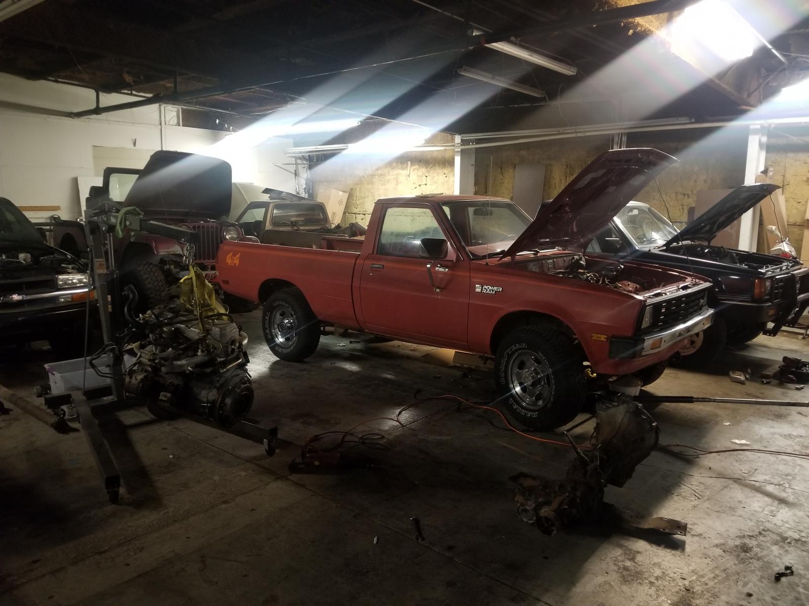

    Small update.
    So I ordered the Energy leaf bushing kit, and it should be here early next week.
    Tomorrow I will officially pull the 4d55 for the swap. The transmission is back near its place, and ready to be bolted up.
    Tomorrow I will finish the hydraulic pedal set up, and I am hopefully it all bolts up smoothly.
    I purchased a clutch kit, and replaced the release bearing. Monday, or Tuesday I am looking for the first start up. Stay tuned. Josh
    The light flare in the pics looks like photos from inside a cathedral. Good luck with the first start up
