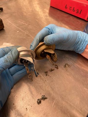

    New update, I've discovered that the vacuum advance diaphragm on the distributor will not hold a vacuum, how difficult is it to find a new one?

    Thank you so much, I had forgotten about summit! I actually found the same part on Amazon after some searching, I think they'll get it here faster than Summit but I'm going to have to cross my fingers and hope it works. I'll update the thread after I get it

    i've been doing some more research and i think the vacuum advance i have on the way is not going to work, the distributor for the 2.4 is different than the one for the 2.0. i may be forced to buy a whole distributor just to solve the issue with the damaged vacuum advance diaphragm

    My apologies, I misspoke, the distributor between the 2.6 and 2.0 are different and I have the 2.0 which is why I'm doubting the part I bought will fit. I'm going give them a call and see what they have because the refurbished distributors are getting them somewhere

    well so far I received the part and it doesn't fit unfortunately. I pulled the distributor off of my other 2.0L truck and timed it, it runs but the idling issue isn't solved. I have not found any further vacuum leaks so I'm stumped. the truck seems to experience bucking or surging which is most notable in the first two gears, even with a steady, constant throttle input.
