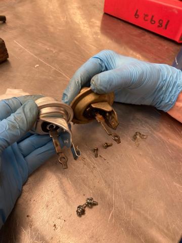

    New update, I've discovered that the vacuum advance diaphragm on the distributor will not hold a vacuum, how difficult is it to find a new one?
    1,549

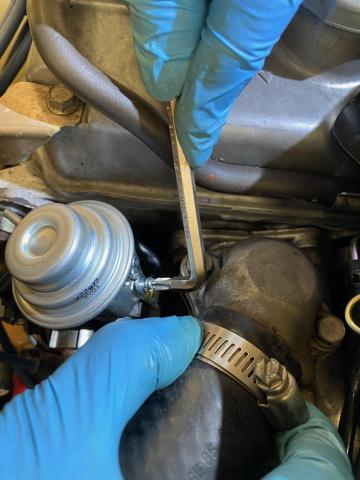

    Mitsuzero it seems that (now) none of the auto parts stores stock or sell a vacuum advance control for our distributors..! My memory is shot but I think it was O'Reilly's that sold me a vacuum advance for my 1986 truck a few years ago (my install photos below) I was able to replace the vacuum advance control diaphragm part without having to remove the distributor by using an offset Philips screwdriver...

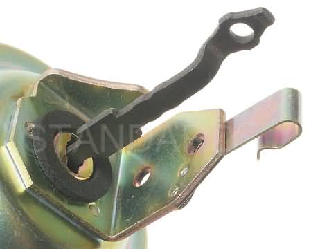

    SUMMIT RACING SELLS IT: https://www.summitracing.com/parts/smp-vc268
    Here is a link to the 1987 part that fit my 1986 truck and it might fit the distributor on the 2.0L engine as well... There is a Tel No. at the page bottom to contact Standard Parts Company & hopefully they can source the part...
    https://www.standardbrand.com/en/ecatalog?partdetail=VC-268

    i've been doing some more research and i think the vacuum advance i have on the way is not going to work, the distributor for the 2.4 is different than the one for the 2.0. i may be forced to buy a whole distributor just to solve the issue with the damaged vacuum advance diaphragm
    1,549
    Mitsuzero I am confused & I don't know which year trucks got the 2.4L engine AFAIK the 1987 and 1988 trucks have either 2.0L or 2.6L engines..?
    Your truck or your distributor is a 2.4L engine or distributor..?
    You should be able to find a vacuum advance for the truck w/o having to buy a whole new distributor...
    Try calling STANDARD PRODUCTS For Catalog assistance: (718) 729-4357

    My apologies, I misspoke, the distributor between the 2.6 and 2.0 are different and I have the 2.0 which is why I'm doubting the part I bought will fit. I'm going give them a call and see what they have because the refurbished distributors are getting them somewhere
    1,549
    Should fit
    Take a good look at your part, does it look simular..?
    10-10-2022
    40
    Rome Georgia
    well so far I received the part and it doesn't fit unfortunately. I pulled the distributor off of my other 2.0L truck and timed it, it runs but the idling issue isn't solved. I have not found any further vacuum leaks so I'm stumped. the truck seems to experience bucking or surging which is most notable in the first two gears, even with a steady, constant throttle input.
