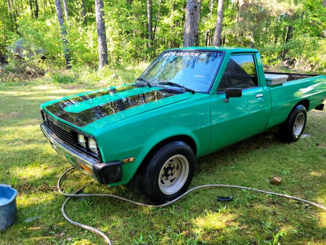

    Yes sir she unique the paint is a wild off green wish I could find the paint code for it.

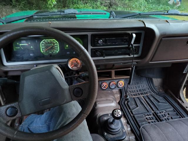

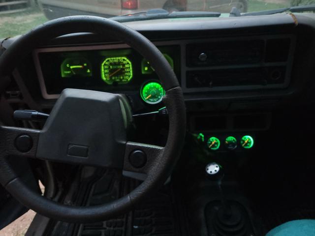

    Anywho ended up fixing most of the rats nest wiring got the gauges working and found out my cluster lights up green?
    So opinions on going full green on the rest of the gauges?

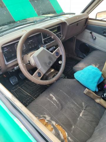

    Here are some photos of the current setup using a bt adapter for my phone due to lack of good local radio.

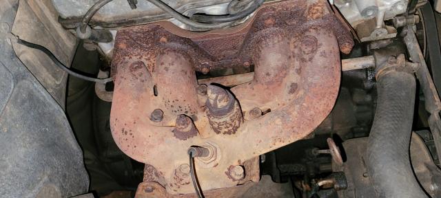

    Well I did just end up zip tieing the grille back figure I'll find one someday also side note since I bought the truck it has had some odd issues
    Main issue was this rattling at around 3k rpm looked into what could cause it from crank pulley to bad clutch plate etc etc... turns out was the heat shield on the factory manifold pulled it off 2 already broken bolts and noticed I have a 4" long Crack on 1 runner and a wonderful 2mm hole in one side where it has cracked and fallen apart..... so searching for a El cheapo header.

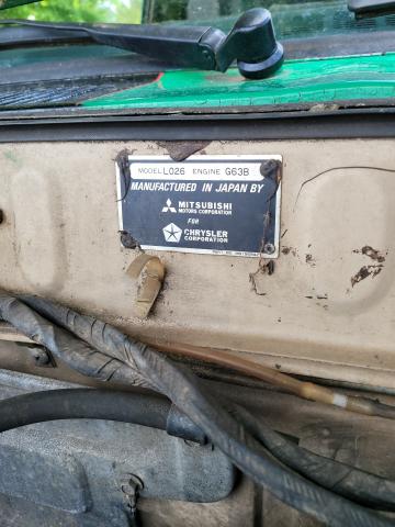

    Also noticed I had a O2 sensor and under dash passenger side is a box googled the numbers and it said mitsubishi ecu yet my truck is a G63B carbed vin also states it was a 2.0 carbed I'm new to working on these engines never seen a o2 on a carbed engine.

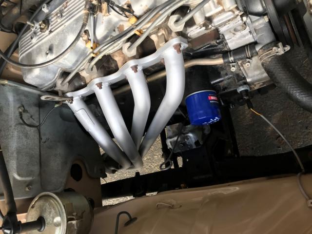

    There are headers for sale on ebay all day long. I paid $160 for one and had it ceramic coated for another $250.

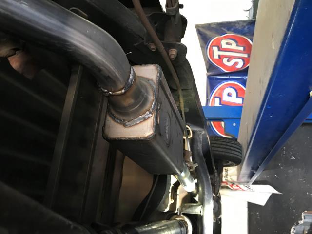

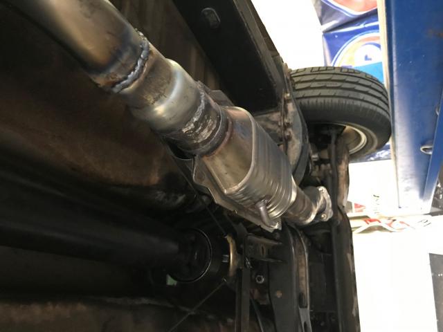

    I ran 2.5" pipe from the header to a high flow 2.5" cat, then reduced to 2.25" to a Spintech muffler and 2.25" tailpipe to the rear valence.
    High flow 2.5" cat:
    2'25" Spintech muff

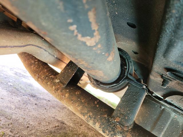

    Also update time I reckon been a busy hell of a week starter went out at first thought it was a wiring issue but turned out the starter was just tired. Well while I was under my truck i figured I'd see if I could find this strange vibration source and noise I was hearing at 3k rpm and when I was over 45mph.e9fb1a2910aa4706d905d9aeab3367c1.jpg
    Don't see it yet let's look closer
    Judging at how bad it was and the rust built up I figure it had been like this for a long time before I even bought the old girl lol ordered a new one and new u joints so that is my current project.

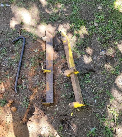

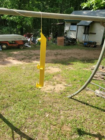

    And a little side story I got these old Slapper,Track bars from a good friend years ago was gonna use them on another vehicle I used to have but they did not fit well I got the idea to see if they fit the truck and they fit it very well so cleaned them and painted figure might as well run them and get some good tires take her to the local drags for some simple fun.
    Color used was John deere yellow later I'll have them powder coated another color
    And my led light conversion is done the triple gauges got a 10mm Led and the Tach used a 74 led bulb they are not stuiped bright but good enough to see.
