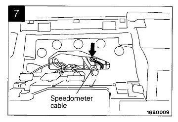

    Since you didn't mention a tach, I'm assuming you have the non-tach cluster. Here's the schematic for an '88. I'd be surprised if it differs for your '89.
    You're right to suspect grounding issues since both gauges act similarly. The ground point for the cluster is behind it (see below). Inspect and clean the contacts of the two connectors that plug into the cluster if they're discolored or corroded. Also, clean the ground points of the negative battery cable in the engine bay. There are three or four points along the cable. Keeping those connections solid and clean can correct or prevent many electrical problems. If this doesn't do it, check fuse #7 and the connector to the ignition switch for poor contacts. If the problem still persists, get an Ohm meter and check the continuity of the relevant wire.
    I don't know the location of the 7v converter. The diagram above shows a voltage limiter (*3) as part of the cluster. It's probably in the circuit board.
    Here's the cluster ground location:
