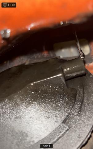

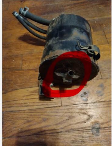

    I’m having issues with a 1989 Ram 50 2.6L G54B. The fuel vapor cansiter located on the front passenger side of the firewall is leaking gas from the bottom outlet/inlet. I am unable to find any information online as to what that outlet/inlet ties into. If you have anything that would be helpful to me, please feel free to share below. I’m hoping there’s a diagram somewhere but I can’t seem to find one.

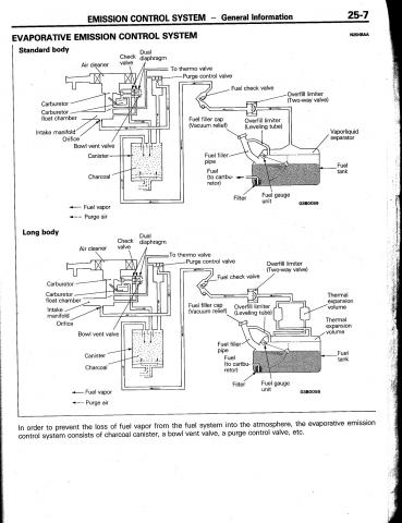

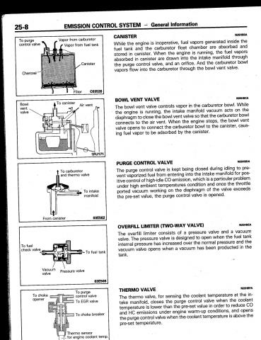

    Does your truck have the Mikuni carb? If so, these diagrams of the Evaporative emission system and its components should help:
    With the Mikuni, likely sources of fuel in the cannister are a failed bowl vent valve or a stuck float needle valve. If either of these are the cause, a rebuilt Mikuni, or better yet, a Weber is the best fix
