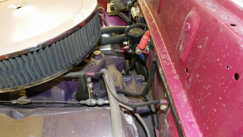

    First time I dropped in the 302 it took me 6 months as I could only work on it when I didn't have a customers car in the shop. The current rebuild is going on 12 years of work when I have time.
    Here's a pic of the back of the engine to the firewall. As you can see I had enough space to mount my starter solinoid behind the 14" air cleaner.
