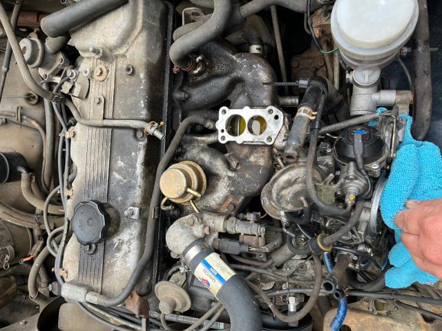

    I'm attempting to install a Weber k 614 32/36 on my 2.6 with 5 speed. This kit did not include a block off plate between the carb and the intake. Does anyone know were i could find one. I'm really thinking about starting my own thread ( manly so i don't hijack another members).
    Anyone have any other thread suggestions or can tell me what all I'm going to need. I was very naive in thinking this would just bolt down and run. The research i have done so far has led me to, adding a electric fuel pump / blocking manual fuel pump. What else am i missing??

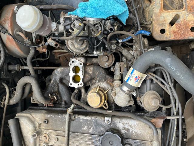

    Thanks for your reply SubGothius, I received the plate to bolt the carburetor to the intake. I was thinking since the stock carburetor is a water choke that the holes in the intake under the carburetor would need to be covered by a plate.

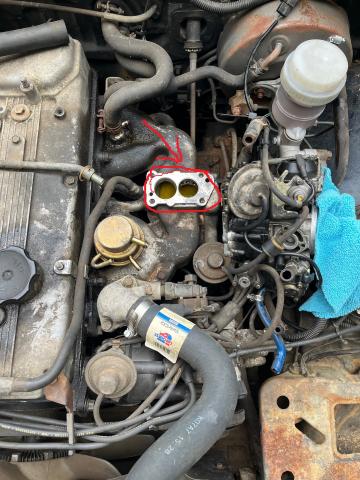

    Hopefully the photos will show up. The holes I circled in red are the ones i was needing to know if they need a plate or not?

    The middle small hole on the left is the jet-valve intake port, which only works with the stock carb. The adapter plate should block that, but I'd also advise disabling the jet valves by removing their lash-adjuster screws from the rockers under the valve cover, or you could even install a jet valve eliminator kit that replaces the jet valves.
    The middle small hole on the right is the coolant port for the stock carb's water choke, which should also be blocked by the adapter plate, but I'd also advise tapping that hole for threads to block it with a grub screw, as described above in this thread.

    I'm referring to the two big holes. Do they need to be covered with a plate or is it ok to have them open?

    Those are where the intake manifold receives an intake charge from the carburetor -- i.e., the carb mates up to the manifold there, so the bottom end of the carb barrels feed directly into those big holes.
    The Weber adapter plates mount on top of that flange, between the manifold and carb, to convert the size and position of those holes to the slightly differing size/position of the Weber barrels, as well as converting the stock hold-down bolt pattern in the manifold to the mounting bolt-hole pattern in the base of the Weber.
    BTW, looks like you got some coolant overflow into the intake manifold there, so you'll want to mop or vacuum that up before installing the new carb and trying to start it up.

    See that is what i was confused about. When i pulled the carb off that coolant was there. I did not think it was suppose to be. That makes a lot more since now lol. Thanks for dumbing it down for me!

    Yeah, that can happen if you remove the stock carb without draining some coolant first, which overflows from that coolant port in the carb mounting flange that you'll wanna block with a stainless grub/set screw (M6 or M8, I forget which) sealed with Loctite or hi-temp thread sealant.
