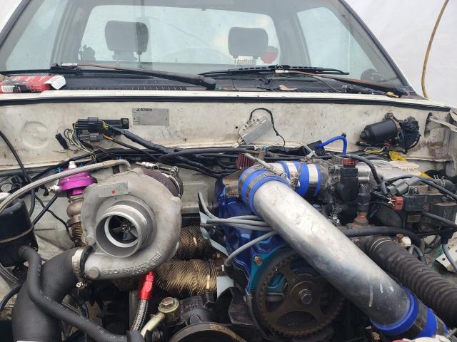

    Turbo manifold? Would need to be custom made. What I did is had a buddy cut me out an exhaust manifold flange, and I built my own.

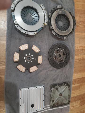

    The 5spd transmission (R5M21) will need the tuff pan on anything close to 350hp or greater to prevent the case from expanding/seperating. I recommend DFab designs. Their billet pan is amazing! (Images will be posted below). For the clutch and flywheel. I'm currently running the heavy stock flywheel. Ebay 'stage 5' 6 puck unsprung clutch. It's supposedly rated for 350hp and 380tq, I have spun it at the top of 20psi, but I would recommend a traditional sprung style for street driving. I'm going to get in contact with Centerforce to see if they can hook me up with a lighter flywheel and sprung clutch combo.

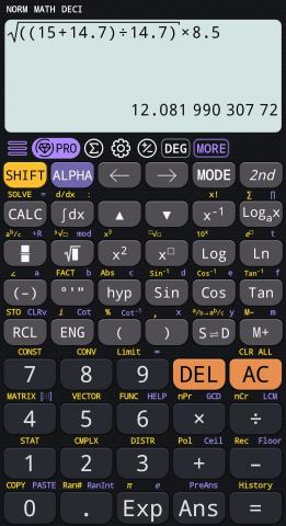

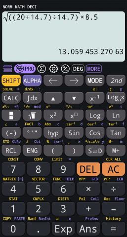

    Here are the calculations for ECR (Effective Compression Ratio) with boost

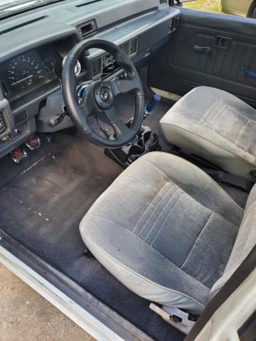

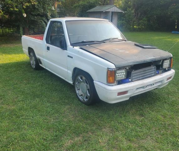

    And now starts the following images of where my truck is currently. I'm going to be moving to a single bulkhead connector to rid the firewall of the atrocious factory wiring harness. I'm also getting my charge piping welded up and a forward facing intake setup for a cleaner look. I will be cutting all the inner fenders out, possible partial tube chassis up front, as well as cutting the bed floor with some custom suspension work front and rear.

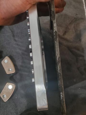

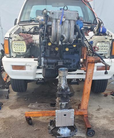

    Here is an OE pressure plate and clutch compared to the ebay setup. I did have to have the flywheel resurfaced as well due to some hotspots. Also a comparison on the billet tuff pan from Dfab designs compared to the stock pan.

    It's a 64mm (turbine size) with a 76mm inlet size 50 trim. Just your regular run of the mill Ebay T04E going strong.
