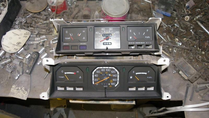

    I have 2 parts gauges that are from an 80 2wd with no tach and an 84 2wd with no tach. both have parts missing as I used them for my custom gauge cluster. they would need the light filter (showing the idiot lights) and you might have to change the speedo to yours as mine are in KPH not MPH. if you're interested message me your address and send you one if you need it.
    Top is 80, Bottom is 84
