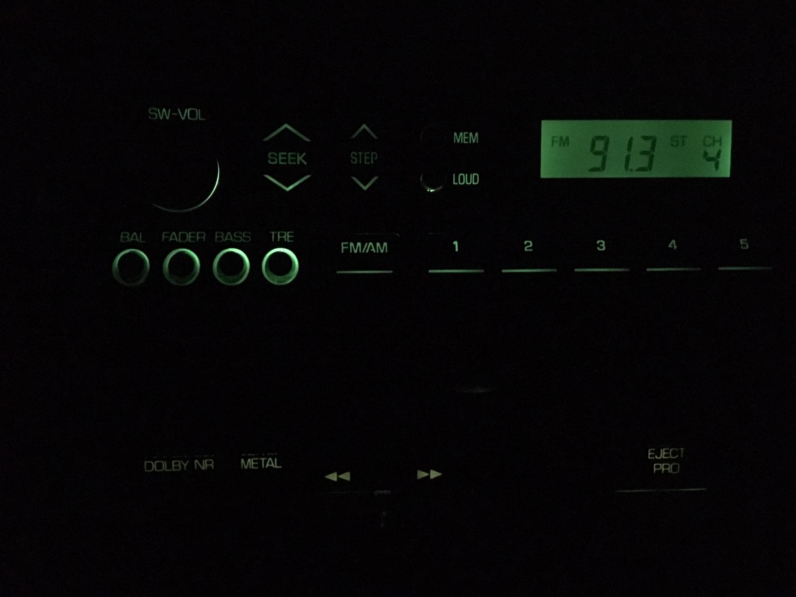

    ^^UPDATE
    I ordered one of these radios. Arrived today, installed, and working great.
    Posting this in case anyone out there wants to get their hands on a mint early 2nd Gen AM/FM radio (I don't know if later model years had more advanced radios, but it would make sense).
    I don't know why or how, but this seller seems to have a few of these original radios. They are not the cheapest, but for anyone looking for OEM equipment in excellent condition, it might be worth it (compare prices and condition to what's on car-part and you'll see what I mean). I'm not associated to the seller, btw.
    This is the one I bought (J891), it arrived as advertised, very very clean condition, and everything works. This guy had 3 more of these AM/FM digital radios, as of this posting.
    https://www.ebay.com/itm/143007966300
    Here's a picture of the one I just installed. Just the top part, the cassette player I already had.
    For those of you with Monteros/Raiders out there, he also has some with the orange lights (J892). These are labeled as "new":
    https://www.ebay.com/itm/Mitsubishi-....c100005.m1851
    Remember-
    J981: Green lights
    J982: Orange lights

    Awesome! did the bass/treble/fader/balance knobs work properly? they will do all sorts of weird things if they don't like crackle and loose all bass or treble and if the balance goes out most sound will drop out of one side. that was what mine did. but maybe the J891 has improved potentiometers over the 3 J987 (2 speaker) or J989 (4 speaker) models that i have?

    The bass and treble knobs work properly,they do the job. The sound coming out of it is probably as good as can be expected from a 30+ year old stock radio, it's definitely not a high end stereo, but it sounds very good.
    The fader knob works, but I would say that it only takes the power down to about 10% on the opposite speakers to where the knob is turned to, it doesn't silence them completely. The balance knob doesn't seem to be doing anything, sound comes out of both sides no matter where the knob is turned to.
    Is it possible that these two knobs are functioning funny because the speakers in the truck are undersized for the radio, maybe?
    In any case, it doesn't make a difference, I have no need to balance or fade the sounds from one side of the cab to the other one. Come to think of it, I don't know why anyone would need to do that anyway.
