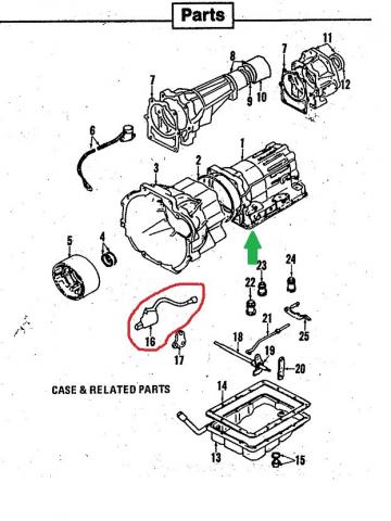

    Update: Think I found it in a parts book. It's circled in red in the illustration below and located in the area above the green arrow on the trans. As the FSM stated, it is installed on the control lever (#20) with a bracket (#17). The switch P/N is MD722663.
