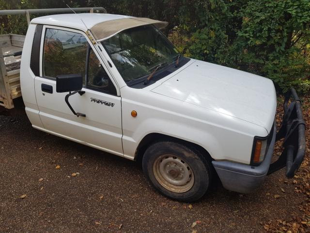

    This is my 1992 Triton - it has sat it my shed for a few months while I worked on another vehicle. That car is now finished so the Triton is next on my list.

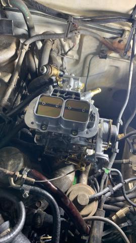

    The Mikuni carb is bad so I'm some way through replacing it with a chinese Weber copy - I've actually done this swap before on a much older car I transplanted an Astron into back in the 1980s. It's fun to have a 4G54 powered vehicle again. Engine runs strong when it's running but I can't hurl that Mikuni far enough away.
    It's a bare bones cab-chassis, filthy inside. Radio missing but I am putting a spare one in there. Haven't checked the suspension yet but there is some play in the steering so I assume I'm up for at least a few parts there.
    Looking forward to working on it properly now.

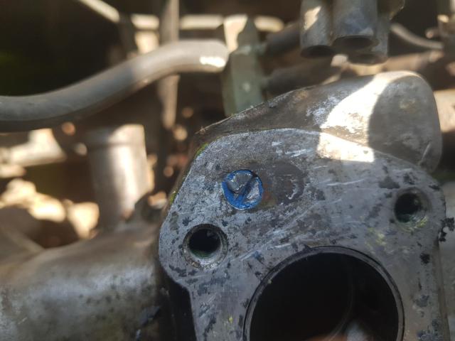

    Pretty neat truck you have, the visor & bumper guard are rare items here in US especially the very rare cool visor... ? Should we know what the intake PLUG is all about (I am Weber ignorant)
    That plug is for a coolant passage that the Mikuni uses for its auto choke, which the Weber does not use, and adapter plates may not block it completely/reliably, so it's recommended to put a grub screw in there just to be sure.

    Vent windows on a 92, WOW!

    Quote Originally Posted by maddmax View Post
    We must have got some different vehicles - it still has the Astron 2.6 in it rather than the 2.4 it looks like the US got.
    This is what's going on in that picture. The bit you can't see is there is another pipe that needs to be blocked off toward the back.
    This is the Chinese made Weber 38/38 clone hooked (mostly) up and running really well. Full confession: we used to do this back in the 1980s on our Chrysler Galants (maybe they were called something else in the US like a Colt or something). The mikuni carbs are fine when they are going but really hard to fix, where a Weber is a much simpler device and adds a few precious HP.
