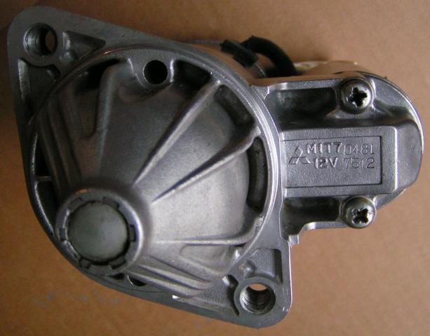

    Lastly, the correct starter for the truck should have the identification number M1T70481 stamped on the front mounting bracket between the two screws holding the solenoid. Here's a pic of a spare starter I have showing the number:

    Alright I got time to inspect everything today and I found this, O'Reilly universal 13lb radiator cap, it does have an O'Reilly saftey Stat fail safe t-stat. And here is the starter that O'Reilly gave the PO and is currently installed. M3T 32995

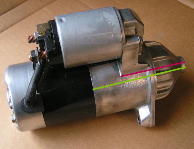

    The cap should be fine. Was the t-stat locked open or installed upside down? I'm wondering if O'Reilly sold the PO a starter for a 2l engine. Per the FSM, its ID number is M3T41081. I couldn't find any starter or info with the ID number M3T32995.
    The starter for 2.6 and 2.0 engines with auto trans has internal reduction gears while the 2.0 w/manual trans is a direct drive type. The front mount bracket of the 2.6 starter houses the reduction gears and is longer (the green line in the photo below) than the bracket length of the 2.0 starter (represented by the red line).
    Looking at online images, the difference in the front bracket appears to be consistent regardless of manufacture.

    Alright I'll head over to my napa and get a new starter as the one in there is definitely not that one or that size, i tried to post the photos i took of the reman starter in the truck but it kept saying faild to upload. The part number is scratched off the only thing still legible is the M3T but I know for sure the second digit after the M3T is a 2 but it's the wrong starter so whatever. I have not pulled the Tstat housing as I don't have a gasket for it yet but I will when I pull the rad out to replace it, all I know is that it's a fail safe Stat and 2 or less months old based on the receipts I got. The PO said that replacing the Tstat did not change anything with the cooling issues, so my guess is for the time being it's working properly whether or not it's installed in the correct orientation is a different story. Pulling the rad cap and looking in the rad I can see goo and A LOT of stop leak in the visible fins, I'm gonna put a test tank on the hoses and run the water pump with my milwaukee and dump some coolant flush in there, maybe some ascorbic acid and see what I knock loose before I put my new rad in

    Divisible_by_0 - Looks like you have the solution to the starter issue and are correct about a thorough flush of the cooling system as the next step. If there are white deposits around or in the radiator passages, that may be aluminum oxide. An acidic flush will help remove some of it, but not from passages that are completely plugged. Another forum member used a heat gun to break up the deposits, but I've always had a shop rod out the core or just replaced the radiator. Is your truck 2wd or 4wd? The rad sizes are different.
