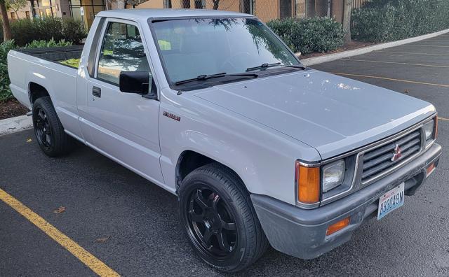

    @xboxrox. I can understand where you are coming from. For clarity. I meant that we are putting the money into MM for me. Son will drive one of our cars.
    @finalfighter. Appreciate the advice. 2 cents is twice as valuable as nothing! I think I'm going to pursue the route you suggested. I'm going to do some research and then start a build thread.
    For anyone that cares. I will include a pic of MM out of paint. Some overspray that I need to address, but I am pretty happy with the look so far.
    1,549
    WoW MMMM24 Your Truck Looking New & a safe easy to see color too..!
