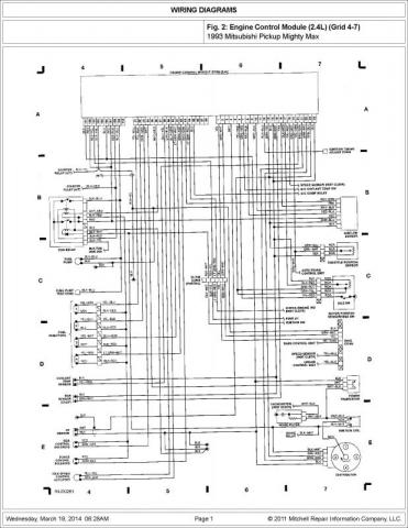

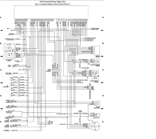

    check the wiring to the igniter. had the same thing recently.

    Well, i gave all that a check and nothing was out of place, burnt, or torn.
    So i had it towed to a shop, and upon doing such i’ve learned my timing belt broke. Now i’m just hoping that i have an 8 valve sohc and not a 16, as the 16s are supposedly interference while the 8s are not.
