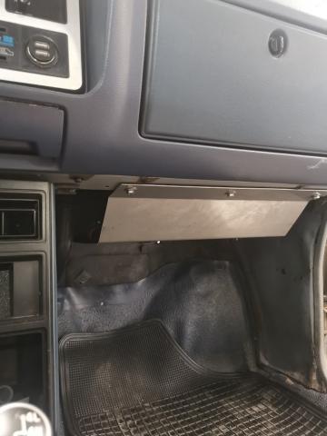

    I was missing some low-end with just the 4" door speakers, but space was limited for a regular subwoofer without sacrificing passenger space.
    Thought of getting a slim subwoofer and placing it beneath the seat, but there wasn't enough space. Space behind the seat is filled with necessary tools, air compressor, fluids etc.
    The solution was to mount the subwoofer up underneath the glove box. I made a plate in stainless steel, attached the subwoofer to the plate on rubber stands, and the plate to the dashboard with rubber gaskets to eliminate vibration. The reason I used stainless steel is I got my hands on some scrap from my workplace where we use 316L stainless.
    01.08.20
    01.08.20
    Plenty of leg-space left, and the subwoofer is mounted securely.
    The subwoofer I got was a generic 150W 8" slim sub with passive radiators for about $120. Pretty happy with it, and it sounds amazing. Jaws drop when people hear what it sounds like as they don't expect much from this type of car.

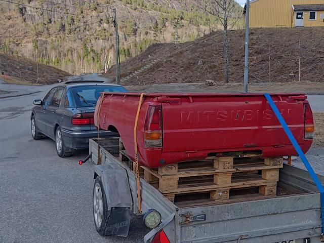

    Yesterday I brought home an '82 L200 that has been sitting outside for 20 years.
    These first gen L200s are so rare here in Norway that I just had to take the chance, and see if I can rescue any parts from this one.
    11.10.24
    When I first saw it, I thought "what have I gotten into" as it was burrowed in dirt, leaves and looked in really bad shape.
    It was also a 1982 model, which is somewhat different than mine. Headlights, grille, instrument cluster, steering wheel with stalks and seats looked a little different. Engine was a 4G63, same as the one sitting in mine, but with minor revision changes to some parts.
    This one is a DL022G while mine is a DL026G (VIN)
    12.10.24
    It had a really nice patina once I got it home and removed the dirt and leaves. However, it had seen better days.
    The truck bed, floor and parts of the doors were rusted out, but the interior and engine looked to be in good shape.
    It came with a 4G63 and a gearbox from an L300 sitting in the truck bed. This one is slightly different to the L200, with the alternator on the other side and an upgraded carburetor.
    12.10.24
    Pressure washed it to remove the 20 years of growth on it, made it a bit easier to see what chassis parts are saveable or not.
    Shame to remove this patina though, part of me wanted to get it rolling and drive it as-is, but that's not going to happen as I cannot get it registered.
    12.10.24
    Found the original grille laying in the truck bed.
    Going to sell the parts that don't fit mine, save those worth saving, and scrap the rest.
    My main goal for the next week is to get the engine running and check the health of it, then part the car out completely.

    Kind of forgot to post this one, but I was able to get a bed in good condition for $120
    A guy contacted me back in March and asked if I was interested, as I have a craigslist-type ad that I am looking for any parts for these 1st gen. trucks.
    He lived about 5,5 hours away, so me and a relative of mine set off with my Galant and a trailer.
    When I got to see it in person, I was shocked of how good it was in terms of rust, even had the rear lights mounted!
    29.03.25
    Here's the trustworthy Galant on its way with the trailer.
    29.03.25
    Picked up the bed and returned home, it's now stored upright by the wall in my garage.
    The plan is to get this in mint condition, swap out my bed, and then try to overhaul the old bed.
    I'm considering a dark grey color for the car, when I'm going to paint the bed anyways. The silver is practical, but I really like dark gray like the Galant.
