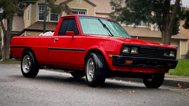

    At what point is a vehicle worth a build thread?
    Never?
    As soon as you purchase it?
    The answer is never clear. So here I am, 7 months into ownership of this final year first gen 86' Dodge Ram 50 4G63B, 5 Speed manual. Let's just say this truck entered my hands as a $400 beater. I wasn't exactly sure how long I was going to keep it, I just know I needed a little truck or wagon to haul parts around as my Audi 5000, and my Volvo 245 had both been totaled on the same day a couple weeks prior.

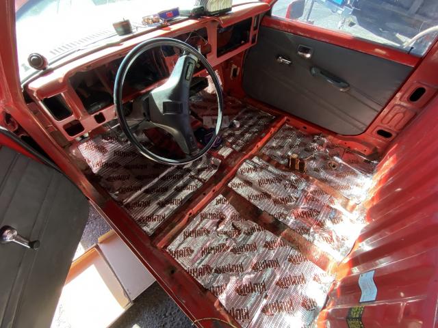

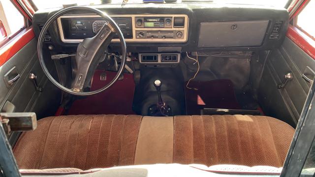

    For the most part it scampered around for a couple months as an errand boy. The unbolted E36 drivers seat, and equally hardware rich toyota hilux passenger seat were removed and swapped for a mildly more secured Ford Ranger bench seat which remains in the truck currently until I come across a factory red cloth bench seat. It ended up having a breakdown after 4000 miles of nothing but back and fourth runs for parts runs and daily driving which gave me quite the run around, firing the parts cannon off up until I was about to pull the cylinder head off, and discovered the cam gear had been cracked the whole time. During the time off the road firing the parts cannon, I was able to source 90% of the missing components that the truck lacked on a pick n pull run, and sourced an entire uncut wiring harness off a truck being parted out on the Facebook marketplace.
    Lots of things got done during this downtime as well. A full exhaust was made as the setup on the truck when I bought it was straight tweaker spec. A heaterbox, and new speaker harness had been returned to the truck as well.
    As of late, the truck has hauled me around nearly 8 thousand miles since purchasing it and mostly still is used as a parts hauler. I nearly traded it off for an AW11 the other day, but remembered I'd finally snagged an early Sport Steering wheel on ebay the week prior, and realized it was to arrive soon. It's really cemented itself with me for the time being, the steering wheel being a nice touch that holds me over and is one more step away from wiping it's tarnished past away.

    Very nice.. great looking truck.. love the interior work.. I dont have a dash pad so im trying to think of a way to custom make one..(design wise).. im sitting here looking at it and cant believe mine sat that high when I first got it also... now it sits almost too low lol...

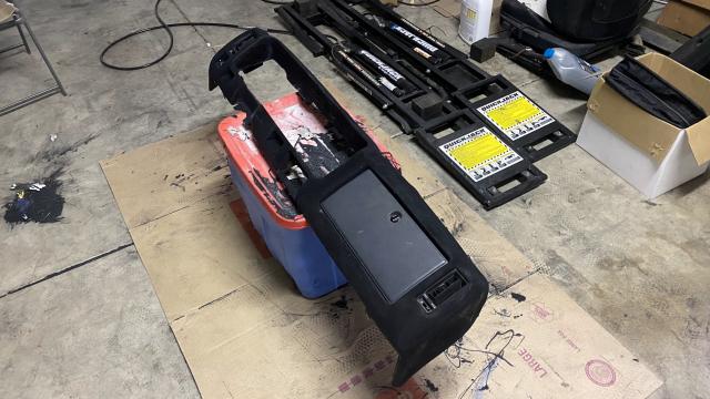

    R_R truck is looking good it's a keeper for sure..! Is there a vehicle lift in one of your photo..?

    haha, I agree! Nothing is more American than building your dream in the garage. The hoist is my bay at work, as I’m a Subaru Tech.

    The two yellow labeled items above the dash..? Those are lifts..? I worked on my truck today grease wheel bearing, my 1st time ever, sucky work!

    Oh yeah! That is a small lift for things at home.
    1,572
    Them Quick Jacks might be handy (safe? Allowed?) @ DIY carwash stall,mmm.

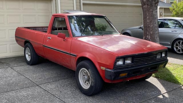

    Another week, another round of funds dumped into the truck. Unfortunately I got a ticket for improper/expired registration back in November last year, and had to address something I was really neglecting: figuring out smog, and registering a car in California. As you can imagine, there was no way in hell this truck was passing smog. My original plan was to go the same route I do with all my other vehicles and register them historically back in Michigan as it is very cheap, permanent, and can be done by mail with proof of Michigan residency. This however was foiled due to the fact that someone else had signed off on the buyer section of the title, and in MI that is a no go. The title was as good as junk. As I was in MI for the holidays, I was informed by the DMV there I'd have to have the truck in person to register it there unless I had a fresh copy of the title I could fill out for myself.
    So plan B: Figure out how the hell I was getting this thing registered in California. Luckily once back in California, having a bill of sale wrote out from the guy who signed off on the title is a valid move as long as I still had the copy of the title. I ended up getting a passing smog, and got the truck registered. This has probably been the biggest expense so far, setting me back a cool $1160 in total.

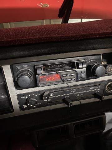

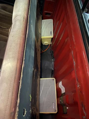

    This round I got the period correct Kenwood tape deck functional, and installed speakers to the truck. I had wired the truck for a proper stereo setup when I had the interior out and insulated the cab, but never got around to installing speakers. A couple weekends ago I got my hands on a set of kicker 6.5s in boat boxes for $30. I retained the boat boxes as I worry about the cab leaking due to the shitty sunroof seal. In the dash is a PolkAudio 4x6 to give a decent high end, and the kickers follow a good midrange. The truck is wired for a sub, and would like to figure out a low-pro that doesn't sound like tin to fit under the seat. For now, it does sound great as it is being that a single cab doesn't take much to fill with sound.

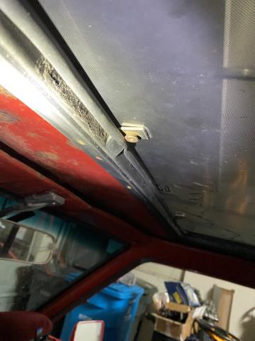

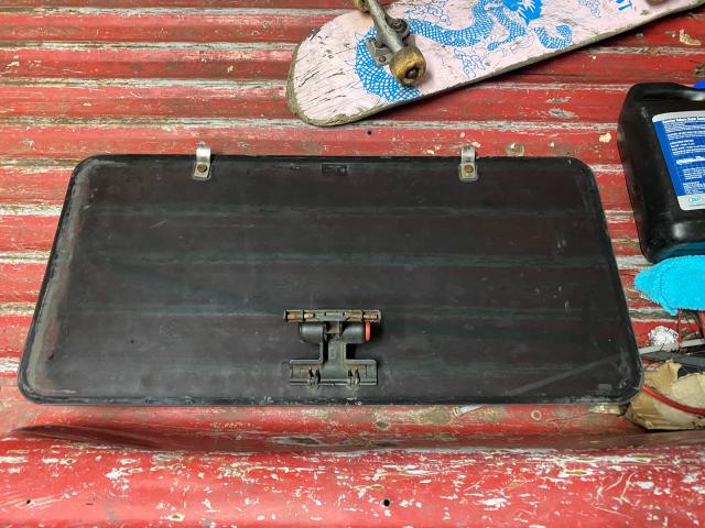

    I also made an attempt at tackling the sunroof seal, which made it better but hasn't totally solved my leak. I need to silicone the seal I crafted as water gets under it in the crevice I have it wrapping over.

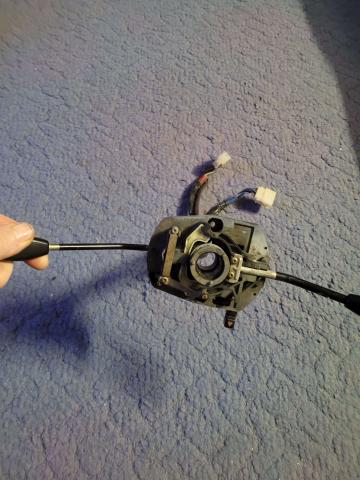

    I am on the hunt for a couple pieces if anyone has them. I'm looking for a functional headlight/wiper multifunction switch, my lights will only work if I hold the brights on. I've gone through the harness, swapped out the relay for a known good one to no prevail. The headlights work intermittently, no matter how I touch things it's at the mercy of the headlight switch completing it's ground circuit.

    I have one I pulled from my 86... unknown condition as I got the truck as a bare shell/frame.. I put a 90 eclipse one in mine..

    PB'laster touts rejuvenating rubber as one of its uses, so you might try treating the sunroof seal with that to see if that restores pliancy to improve the sealing against the glass panel. Also, if that glass panel has no edge trim, use a green ScotchBrite pad with dish soap and vinegar to scour away any deposits where the glass meets the seal.
