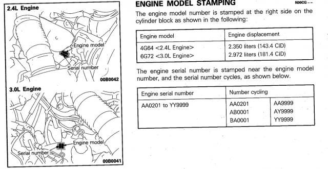

    thanks for the info right now the truck is on a friends property along with some other projects when I get a chance I will check it out. is there any way to make shore what is in the truck actually matches what the plate says it should have in it

    The engine code for the 87-89 model years is stamped on the block in the locations shown in the illustration below. I believe it's the same for 86 and older.
    If the truck is a 1990 or newer, the engine codes are as shown for either the 2.4 or 3.0 ltr engines:

    I have 4g64 thanks
