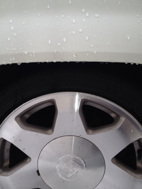

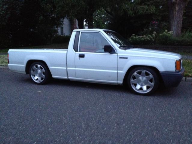

I'm concidering putting drop spindles on my truck, it's already down 2.5 with the belltech drop springs. Will I have any issues? My tire size is 225/45/17 on escalades. I asked on the Facebook page and got 2 completely different answers. One said no prob and the other sent a pic, he's down around 5in, and says he has trouble turning. Any thoughts?
im running 205/45/17 with 5" drop in the front and its pretty dam close. any bigger and i would definetly rub. but seeing how your doing 4.5", you might be alright.
Bobbyk Could u post a pic of your truck or email me one? I'd like to see how close it is.
i'll post some pictures when i get home tonight
i hope this helps alittle.
First, thanks! I think I'm gonna do it. Looks like I'll be close. U look like u have more room than I expected.
no problem. i think you'll be fine, if not then just put smaller tires up front. a good stiff drop shock will also help. im running toxic shocks and only rub sometimes when someone is driving with me.
