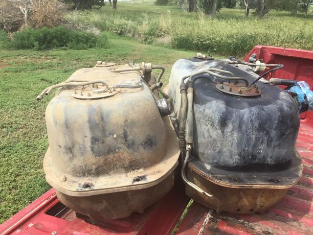

    Sometime the difference comes down to capacity rather then fit I found that a 90 short box D50 4WD could be replaced with a 92 2WD tank just a few gallons difference.
    pic of the 2 tanks side by side ones sitting on a 2X6 piece of wood.
