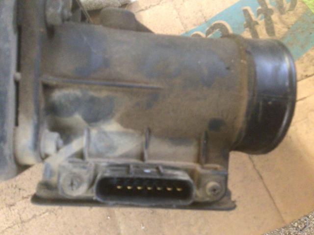

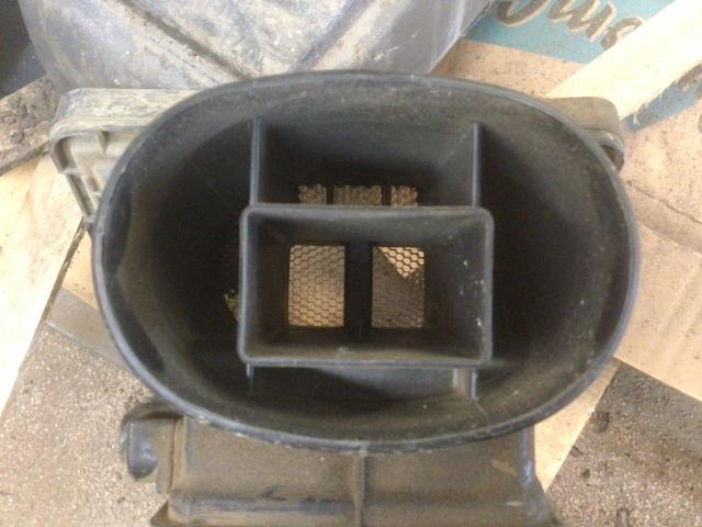

    I’ve got one off of a 92 2.4 that had head issues it should be good. From a truck I parted out a few months ago.

    oh ok, how much you want for it?
    03-23-2014
    648
    Pukwana, SD
    PM sent
