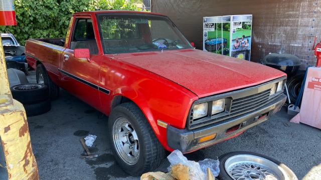

    Long time lurker, first time where I'm stumped to the point I needed to register and make a post.
    This is my 1985 Dodge Ram 50, California emission 4G63B (G63B) manual 2wd truck.
    I bought it a few months ago for $400 needing some carb cleanup and vacuum/pcv lines finished as some kid slapped a weber 32/36 on it and didn't know what they were doing to finish it. After getting it running decently, it's been a solid work truck up until last week after a 400 mile excursion all around the bay area picking up parts for another headache project of mine. Literally backing up into my driveway, it gave up the ghost.
    At first I thought it was a fuel issue, or maybe too low of compression (i'd be lying if I said the compression numbers on the engine are great, and that it doesn't consume oil) However reading another post that I can't seem to find here on the forums, someone made mention of very similar symptoms.
    I believe I have weak spark/dead ICM. Fuel pressure is great, new pump, holley regulator, clean genuine weber 32/36, pressure set smack at 3.1PSI. Timing didn't jump because every once and awhile it will crank to life, maybe it'll idle and then act like it floods out, or other times you can rev it up but when it comes back down to idle it back fires and dies taking quite a bit of effort to get it to restart.

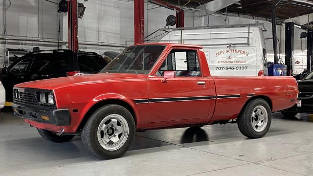

    Update: back to square one. Crank no start/erratic fire. Spark from the coil is definitely good, but seemingly weak from the plug wires.
    07-29-2023
    23
    Santa Rosa, CA
    1985 Dodge D-50
    Another update: Switched over to an MSD Blaster 2, truck runs again but now I'm not sure where to dial the ignition timing into. No matter where I seem to move it, the truck isn't very happy.
    Plugs are NGK BPR6ES gapped at 0.044
    Plugs wires, cap, and rotor are all new
    Distributor is new
    I just seem to be stumped, can't get it to run right, sounds like a bag of popcorn in the microwave.

    Three months after the original post, I've finally pinned down what my intermittent run issue. My truck decided it wanted to have VVT! Now the trouble is actually trying to source the cam gear. If anyone has a 4G63B 2.0 Cam gear I've got paypal/cashapp/venmo ready to go.
