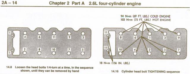

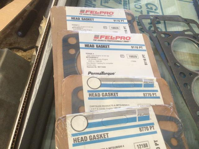

    Is there a head gasket that is considered better than others? I understand they are all made in China these days, and quality is not what it was when the truck was built.
    Back to head bolts...I have confirmed everywhere I looked, and in face to face conversations that TTY bolts were not used in this engine. I believe TTY bolts are put in new vehicles so that the re-torque procedure is not necessary, and head gasket failures don't surface in the longer warranty periods cars have these days. The warranty period for my truck was 1 year, or 12k miles. At what mileage should re-torquing be done? and should it be done only on a cold engine?
    Thanks
  10. #35
    07-23-2018
    482
    Seattle, WA
    1988 Dodge Power Ram 50
    Search the StarQuest forum for what they currently recommend. When I replaced my cylinder head 14 years ago, the Ajusa and Fel-Pro turbo gaskets seemed most frequently mentioned and well-regarded. In addition, nearly all the info I found said to replace the head bolts. But based on your search results, looks like the concern over re-using the old ones is unwarranted and you should be fine to reuse the bolts. Interestingly, the factory service manual makes no mention of using new bolts nor does it say to use the TTY tightening procedure. Just tighten them according to the proper sequence and torque and you're good to go.
    The manual states to retorque the bolts after a heat cycle, but some gasket manufactures say not to retorque or that it's unnecessary. See what's recommended for the gasket you purchase and take it under advisement.

    The place I got the head said to make sure I re-torqued the head after 500 miles, but these gaskets labeled Permatorque insinuates not, but I think I would unless told I shouldn't do it. I'm back from camping so time to get busy on it. Thanks for the pointers!

    (was it my FSM..?) Some document stated to re-torque the head bolts again after bringing the engine to operating temp & cool down... I think there were 3 torque steps, some 1st, max 2nd, then 3rd after engine was fully heated...

    FWIW, here's the proper sequence for (re)torquing 4G54/G54B head bolts:
