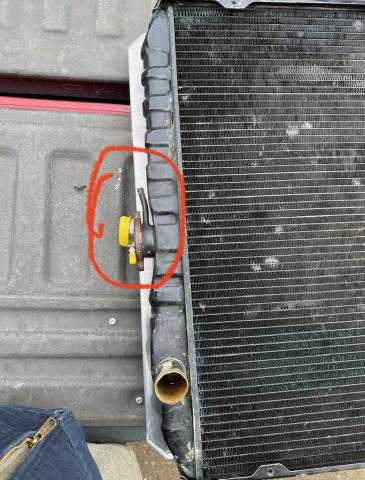

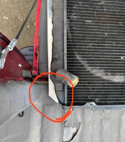

Pics are worth a 1000 words.
These pictures were taken with the mounting holes lined up so the 1988 radiator is bigger on the bottom and the top. The core was almost the same size, +/- 1/16 or 1/8".
With the new radiator resting upright on the frame/radiator support, how far off are the mounting holes? Also, will the hood close without contacting the radiator cap? Maybe you can drill new mounting holes if there's enough clearance at the top. What's the brand/manufacturer of the aluminum radiator?
With mounting holes lined up the radiator cap was about 1" higher than the original radiator. Then adding the ~1" height caused by the frame interference the mounting holes weren't close enough to even me in the mount. I don't recall the manufacture of the radiator. Oreilly's website has an OEM style radiator pictured, not the welded AL style.
My 88 has two sets of mounting bolt holes in the radiator support. One is ~1.25 inches higher than the lower. If it's the same for your 85, can you use the upper set to mount the new rad and retain enough clearance between the cap and hood?
