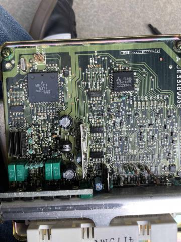

    I've read some posts where the ECU was the issue, and they mention bad capacitors. I pulled the ECU to take a peek (way easier than I thought it was) but didn't see anything that stood out to me. But I've also never looked at the guts of one of these. Took a few photos just in case anyone sees something amiss here.
    The tell tales signs of a bad ECU - swollen capacitors or stains/signs of corrosion around the bases of them and a bad smell. It's been described as smelling like fish? You said you heard a click and lost all on board power. Is there a main power relay in that corner of the truck?

    The caps in my ECU looked like new and I didn't notice any kind of leakage or smell so I'm hoping that is good to go. The main power relay is mounted right below the ECU in my truck, and that's where the clicking is coming from. Since disconnecting and reconnecting the battery, it's working normally but I have to wonder if a poor connection or bad ground there could be causing the erratic behavior. Especially when shutting that door (it's right on the other side of the hinges) resulting in the truck idling way up. Maybe a coincidence, maybe not. Not sure if there's a way to test that relay or grounding, I didn't think about that...
