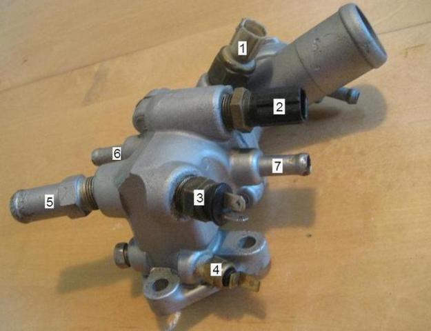

    ive had this happen on a 1g motor.. it ended up being the temp sensor on the t-stat housing.. when it goes bad.. or has a bad connection.. it reads -40 degrees temp and richens the hell out of the system which fouls plugs in like 10 sec... make sure the wires and plug are connected good.. if they are then try replacing it... number 5 in this pic..

    my bad.. #3 is correct one
