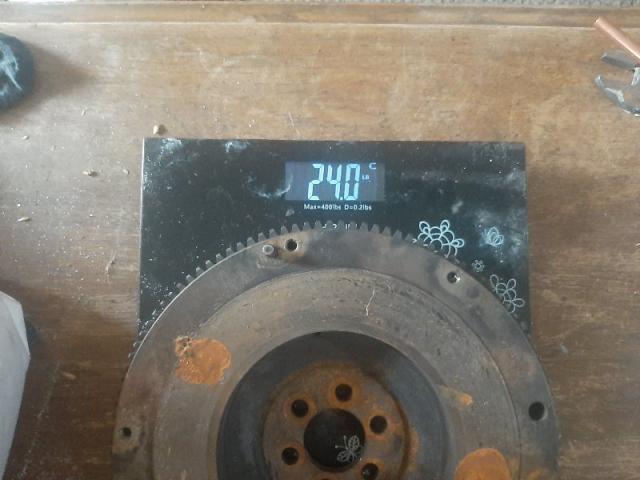

    Here is a Toyota 22r flywheel at 24 pounds. I think I'll get a bigger flywheel next time I build a 22r.
