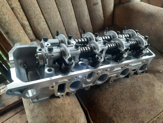

    Head came today. It shipped from CIFIC Auto Inc in Brea, CA. Looks good to me.20230511_191356.jpg
    1,585
    Looks good
    You have the adjustable tappet style rocker arms ~ YouTube and Kevin owner of Clearwater Cylinder Heads Inc. says that most all heads including the camshafts are made in China and (cams) are a softer material ~ for that reason after putting about 250 miles on my new cyclinder head assembly, I changed oil and filter to Castrol high miles synthetic and added a zinc dppt (?) additive ~ I think the rocker arms on these heads are a slipper (?) type that can cause camshaft wear rather quickly ~ the zinc additive hopefully helps prolong the cam life...
    Gotta use new head bolts blow out the block head bolts holes with compressed air & use acetone or other cleaner to get the block and head sqeeky clean before bolting down the head ~ and use a few drops of oil on the head bolt threads and a drop of oil where the bolt head touches...
    Might want to consider all new coolant after the install too...
    My truck stopped using oil after the new head install
