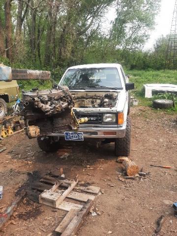

    Go the engine out today. I was pretty gooey.

    A little oven cleaner or engine degreaser should clean that up pretty quick.
  5. #30
    03-06-2018
    626
    Tucson, AZ USA
    Quote Originally Posted by Law Dog View Post
    NON-CAUSTIC oven cleaner, to be specific.

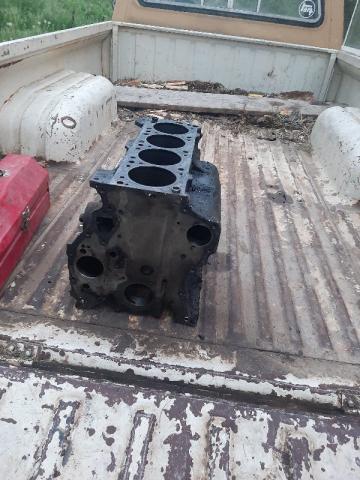

    Got it stripped down. Pretty good ring ridge and the crank is scored a bit. Off to get bored and turned...

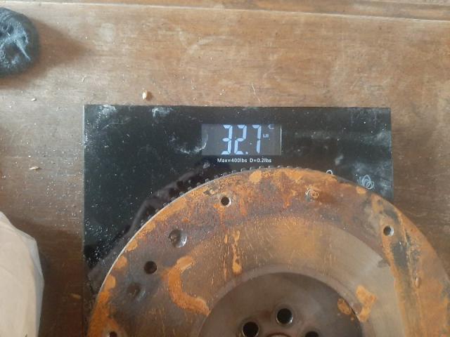

    So we were perplexed when we slapped a set of 31 inch tires on this pickup and it didn't even slow it down a little bit. Figured out why. Now that I have everything apart I decided to weigh the flywheel. 32.7 lbs! Most 4 cyl trucks have like 14 pound flywheels. 33 lbs is in league with heavyweight aftermarket flywheels.

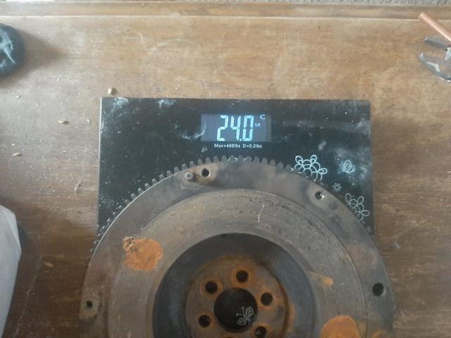

    Here is a Toyota 22r flywheel at 24 pounds. I think I'll get a bigger flywheel next time I build a 22r.

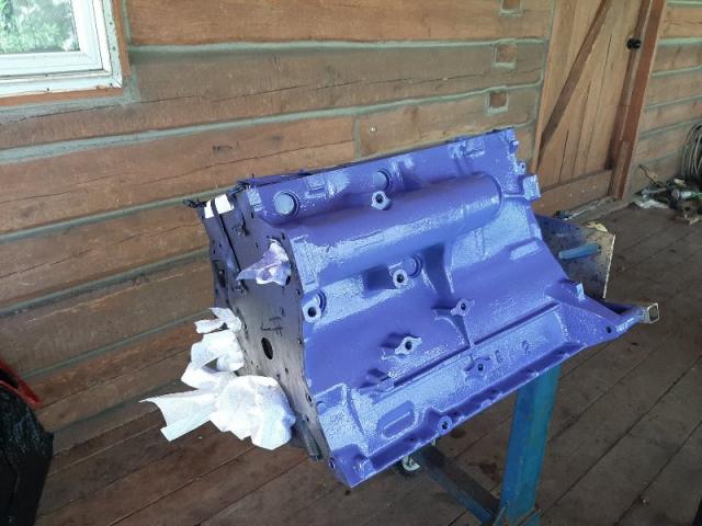

    Got the block and crank back. Bored .030 over. Crank is .010/.010. Painted it macaw blue.

    Looking good.

    you can lighten that flywheel by having the back ground down. I did that on Geronimo over 35 years ago and have not regretted it.
