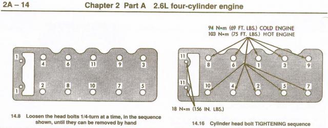

When I see a g54b not running I think head gasket when I see a 3.0 not running I think computer now. I did the stud kit and laminate head gasket on my last build never had any issues until it burnt up in a fire a couple years later. One thing with the studs is to clean the block bolt holes out to get the studs in correctly or the back valve cover can hang up on the breather shield if it’s not fully in place causing the valve cover to not seal correctly.
G54B head bolt torque sequence:
Thanks!

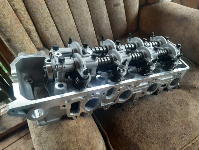

Head came today. It shipped from CIFIC Auto Inc in Brea, CA. Looks good to me.20230511_191356.jpg
Looks good
You have the adjustable tappet style rocker arms ~ YouTube and Kevin owner of Clearwater Cylinder Heads Inc. says that most all heads including the camshafts are made in China and (cams) are a softer material ~ for that reason after putting about 250 miles on my new cyclinder head assembly, I changed oil and filter to Castrol high miles synthetic and added a zinc dppt (?) additive ~ I think the rocker arms on these heads are a slipper (?) type that can cause camshaft wear rather quickly ~ the zinc additive hopefully helps prolong the cam life...
