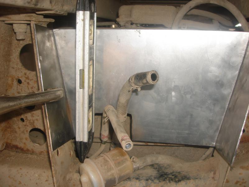

    Bought a 6x18, 22 gauge sheet metal from Ace Hardware like $8, $9 dollars.
    hold it up in front of bed brackets centered ( i eye balled it ) mark sheet metal with sharpie top and bottom where it intersects with brackets. use ruler draw line connecting your two marks, now you have rough angle where to bend. Now use pliers, hammer, vise, workbench top anything you can get some sort of straight edge. Bend sheet metal on the drawn angle take your time bend a little at time unless you own or have acess to ( press break ).
    DSC09732.jpg Take back to truck test fit. i held it in place with vise grips marked where the front edge of bed bracket runs down the length of new fuel pump bracket and cut off excess, it should look something like this when excess is removed.
    Little line far left is fuel return, next is line to carb then from tank.

    the pic in previous post the return line and line to carb are actually touching the bottom edge of bracket, i did not like this and did not want to take a chance on kinking the line if i just bent it by hand so i clearanced the braket for the lines.
    DSC09744.jpg Here the back edge of bracket notched for fuel lines.
    DSC09745.jpg Here before i marked and drilled the holes for mounting the bracket i was checking for plumb or get as close as possible. i did this since this is a rotory pump i wanted to give it the best chance possible of survival.
