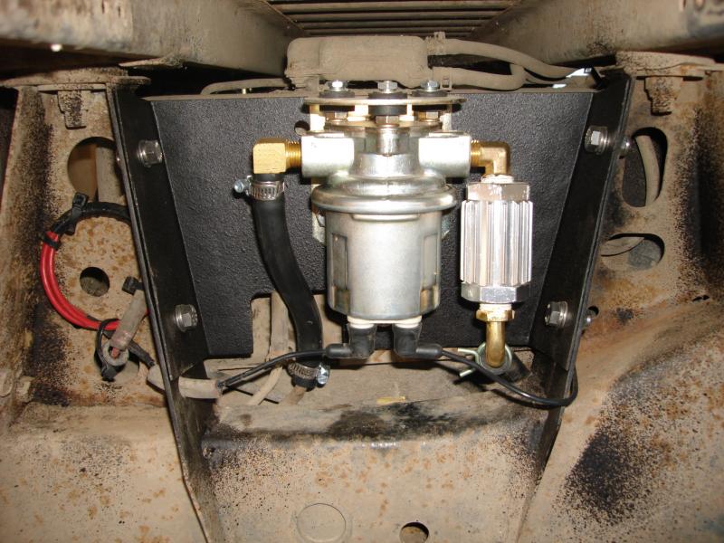

DSC00178[1].jpg I mounted here because hole aready there and didn't want to drill new one, mainly not sure if this is going to permenant location future upgrades may move relay. I had to replace lead from relay to pump which was only 12g and (A) wire too short (B) run was long enough needed to be at least 10g so that is what it got. I pulled wire, carefully uncrimped female connector recrimped and soldered 10g in.
