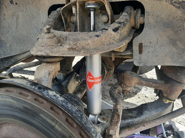

    I ordered a set of gas adjust for the front today. I ran both kyb gas adjust and bilstiens on toyotas years ago and the kyb lasted longer and rode better. In fact I never wore the kybs out.
    01-27-2023
    34
    Highwood. MT
    1989 Dodge Power Ram 50
    Installed the kyb on the front. Wow what a huge difference. Way better rude. Quite a job to get them compressed so they fit through the back of the control arm. Used bailing twine to hold them shut and cut it loose after getting the top pin in place.20230424_170508.jpg fyi
