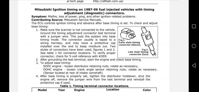

    I have gone through most of the items on that list. Plugs and wires, oil, etc.. I ordered a new MAF sensor and a new coolant temp sensor. I’ve checked the timing and firing order. Still has a backfire and still has almost no power. Is there a way to swap this injection system on the 2.4l for a carburetor?

    The truck was running perfectly for 6-8 months after a new head was installed and then it started doing this backfire/no power this all of a sudden. I don’t believe it is a timing issue since it ran so well since timing was last set. I ordered a MAF sensor and a coolant temp sensor. They should be here today.
