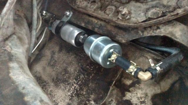

    Looks like the Carbole 42S is rated for 2-3.5 PSI, which should be fine as-is for a Weber.
    As for mounting, I used a Carter P90091 which has a different shape -- long and narrow with an inline pre-filter and a one-bolt band clamp for mounting -- but I found a good place to mount it on my longbed '87 was on the fuel tank's front support rail. The Carbole might fit there if you add an L-section bracket between the rail and pump:

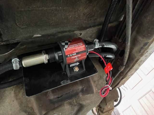

    Thanks for that pic. Its raining of course today and tomorrow so hopefully can get out there Sunday and take a look. Are you going fuel from tank to fuel filter to pump then to carb?
    02-27-2023
    19
    Amelia, VA
    Went with what you did SubGothius. Had some extra metal laying around so built a mounting plate that used the same two bolts holding the gas tank and that tank shield plate you mentioned. Pic of this weekends progress which wasn’t a ton.
