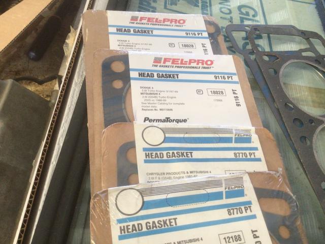

Found a couple of new cam end caps in my parts pile so I dropped one off at the machine shop neighbor. Found some head gaskets options the laminate one is around $60 the standard type is $20 if you add a stud kit you can increase the torque by 20 pounds more. Run a thread chaser through the block threads and the one under the breather tube on the valve cover has to be ultra clean for clearance or you will have a mess.
Not selling my gaskets just letting you know what’s out there.
