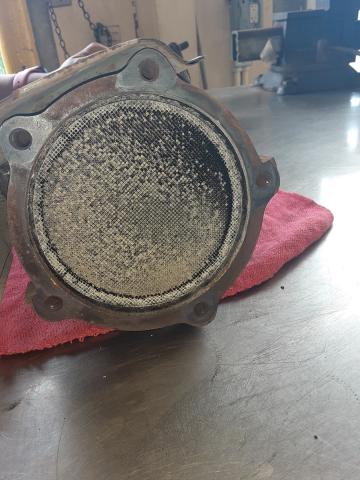

    (The FRONT & REAR catalytic converter assy came out from the top; the exhaust manifold did not need to be removed...)
    Removed FRONT catalytic canister which was melted & plugged inside the exhaust manifold attachment ~ the REAR cat was OK & reused it ~ also discovered a vacuum hose split and not attached to it's barb under the carburetor ~ the truck now runs normal; no miss, no bog..! Photos 'n more details soon
    Thanks to those who gave me helpful advice ;^)

    Good to see all went well. How difficult was it to separate the upper cat from the manifold? I’m very curious to see what it looked like and how you unplugged the upper cat.
    1,549
    We used an air driven impact gun on low setting with 12mm socket to break loose the five front cat case to exhaust manifold bolts...
    Wife helped a lot ~ she used a long blunt nose chisel & small hammer to knock out the melted honeycomb material & she crawled under the truck to hold the rear cat while I bolted the front cat casting onto the exhaust manifold ~ she really was helpful..!
    FMS88 your advice to do this before purchasing the rear cat was spot on (our existing rear cat was alright) & would have saved us $350.00 BUT we will keep the Pacesetter cat as we plan to keep the truck ~ we would have used the new rear Pacesetter cat except it required drilling larger holes to slip onto the spring bolt shafts & it does not come with the bracket to mount the original heat shield metal ~ also, the "V" shaped gaskets they provided were too small I.D. to fit over the pipe end of their cat ~ so, we had to reuse the original formed "V" shaped gasket... and, their cat inlet pipe is a little smaller I.D. than our existing cat (see photo) who knows if it might increase or decrease power... Hope photos answers your ??

    Thanks for your post and pictures. Now I know how the honeycomb was fixed inside the cast iron casing. The surrounding mesh makes sense plus I bet it made removing the honeycomb easier.
    Too bad you couldn't use the new cat, but then by not needing it, you saved a lot of time and effort to make it fit correctly. Nice work on your part and your wife's!

    IMHO that mesh was the only way any exhaust gas was able to pass through the system ~ the photos don't really show that the entire honeycomb was plugged or melted...
    In a 1/2 mile distance WOT test drive to a fwy exit the "before" speed reached was 55MPH and the "after" speed reached was 75+MPH ~ altogether, no real butt-oh-meter increase in horsepower but just a smooth running keep up with traffic daily driver...
