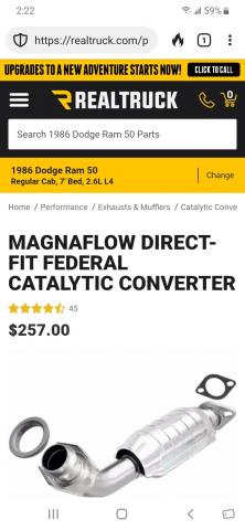

    Photo of exhaust manifold catalytic converter canister taken when replacing O2 sensor:
    PARTS:
    Exhaust Manifold to Catalytic converter inlet Gasket MB687020
    Catalytic converter outlet to exhaust piping Gasket ???
    Catalytic converter as shown in photos below (OEM Catalytic converters are obsolete & not available)

    4) If needed target old catalytic converter on workbench & reuse it's piping ends onto new converter if new converter is not an exact fit...
    5) Test drive with X'd fingers...
    comments, suggestions, bashes..? cheaper ways of DIY..?
