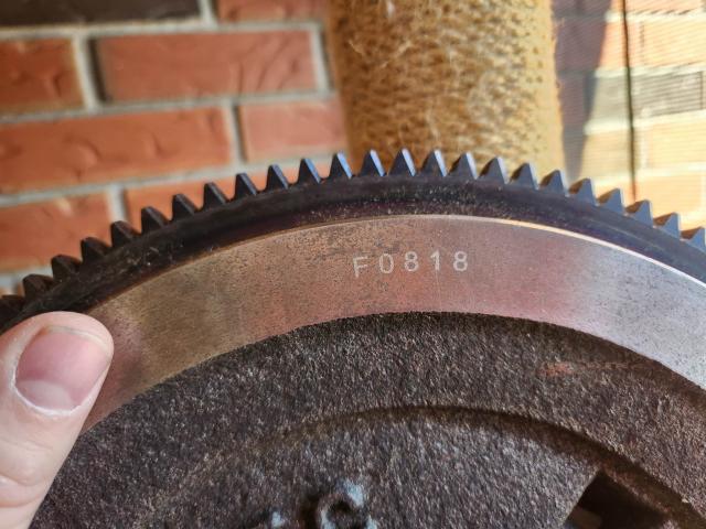

    Arrived today. Looks like it may have been temporarily installed. I noticed no spot for a crank locating pin (not sure if it used one stock though).
    Can't tell if this is OEM or aftermarket or even if it's correct (hoping so).
    Here's some pics, maybe those with more knowledge can tell. It's stamped "54" so I'm hopeful:

    Mitsubishi didn't use a locating dowel for mounting the flywheel, just the six special bolts. The just under 12" diameter and the "54" casting number match my stock flywheel. Don't know about the "2211 AMS" marking. I suspect it's an aftermarket part based on those markings.
    Most importantly count the number of teeth on the ring gear. It needs to be 120. Also, do you have a clutch plate? If it fits the dowel pin pattern or the pins measure 9" apart, it looks like the right part. Still to be completely sure, see if it seats properly on the crank end and check if the ring gear teeth extend slightly beyond the outer edge of the flywheel. On mine they're proud by about 1/8" resulting in an outer ring gear diameter of 12.125"
    Found the aftermarket manufacturer's (AMS) catalog with the description of the flywheel:
