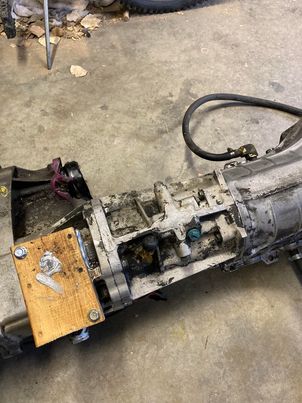

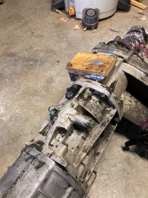

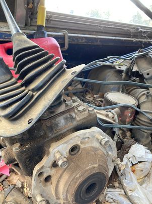

    Can any body tell me if one of these transfer cases is better than the other?. The transmissions are a bit different so I don't know if the transfer cases are interchangeable anyway. The first two pictures are the transmissions with transfer case attached came out of my 84 Ram 50. The third picture is a transfer case from an 83 Ram 50. The one has a bigger shift lever cover. Thanks, Rik
