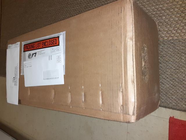

    Purchased a new non Jet Valve cylinder head from Clearwater Cylinder Head Inc. in Florida PART# MIT 108N
    (These heads are Made in China with better alloy & thicker area between valve seats and no Jet Valves ~ to minimize cracking ~ the 5 year unlimited mileage warranty is void if the MELTSTAB on the head is melted ~ melt temp is 255F)
    NOTE: Kevin West at Clearwater searched the shop & found two hydraulic valve train assemblies so he was able to provide me with a hydraulic valve train which I was hoping for... These Starion/Conquest/Ram50 heads are supplied from China with solid lifters which require valve lash adjustment at least once a year or 10k miles...
