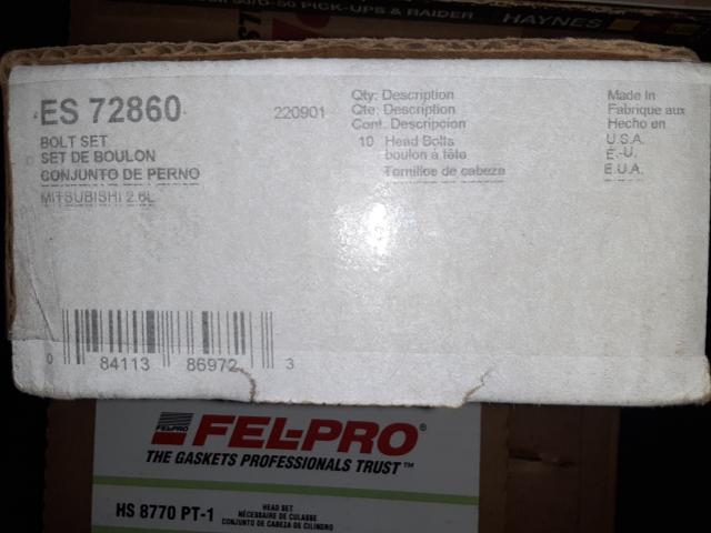

    Purchased new head bolts & a complete head gasket set from O'Reilly's Auto Parts...

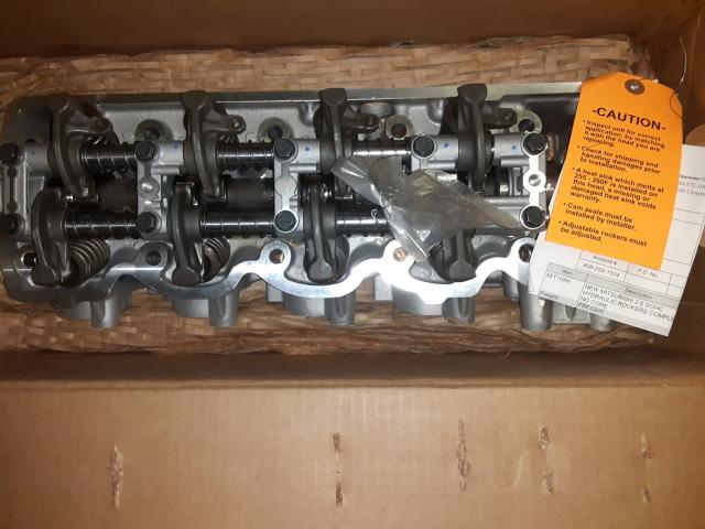

    I'm curious to know where they affixed the melt tab. Also, give it a good visual inspection to be sure nothing looks amiss.
    1,589

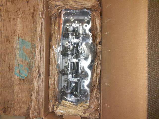

    Yikes..! I never really gave doing this QA stuff much thought ~ I loaded the new head into the truck bed and am just waiting for my mechanic friend (Vernon) to contact me to bring the truck to his friend's house (a two minute drive from my apt ~ will drive the truck there ~ getting the tow truck is somewhat of a hassle & often takes hours or even overnight into the next day ~ some things in Hawaii are not rushed yada yada I don't wanna speak racist etc...) anyway, I am aware these Chinese heads often are not cleaned well & are contaminated with metal shavings ~ also, the complete head gasket set contains a few cam seal & other seal things which might already be installed in the new head (??) I am 100% never done this before ignorant as all heck & not sure what to check ~ but, perhaps I should open the box and at least look at the head before Vernon takes charge of the job (I trust Vernon but I think he prioritizes speed & takes pride in how fast he gets a job done) I want to ask him to look for what caused the coolant leak coming out of the tailpipe and blowing pressure into the radiator and not just slap things back together ~ I will ask him to save the old head gasket and any fasteners for me to look at to diagnose what caused the problem ~ any engine block problems won't be solved or fixed forever by installing a new cylinder head (?) I also will ask Vernon to use the long EGR passage flexible shaft drill tool I have to probe and inspect the intake manifold EGR passage leading to the carburetor while things are disassembled...

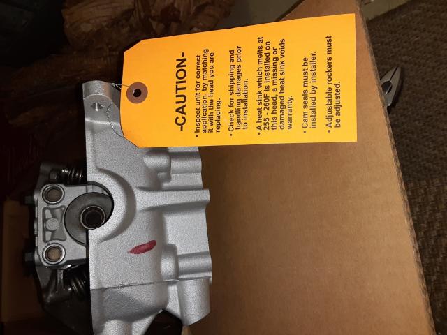

    So FMS to answer your Melt Tab question; I will have to open the box and look or phone Clearwater for the answer because after Vernon takes it away there is no telling what might become of any melt tab..!
    Thanks for helping me think my friend & hope you're keeping toasty warm up there in the great Northwest
    1,589

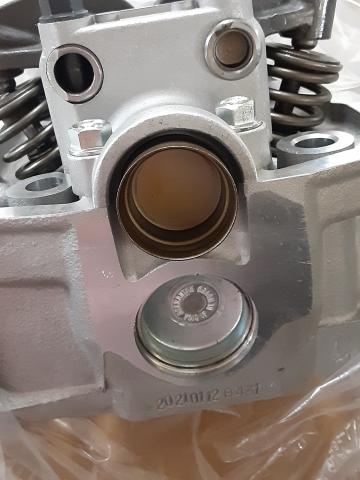

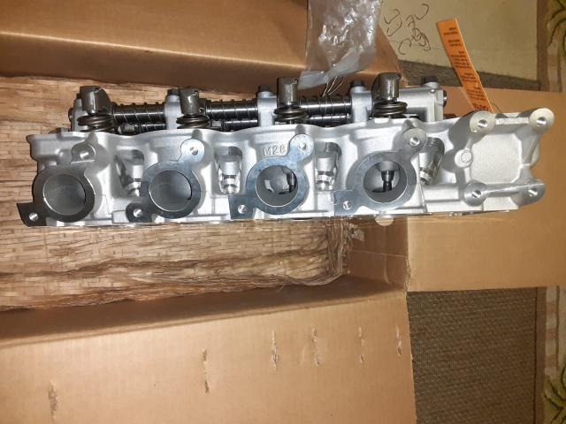

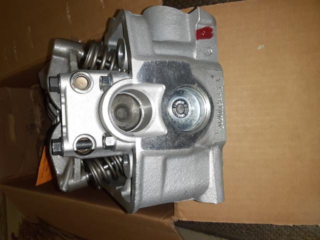

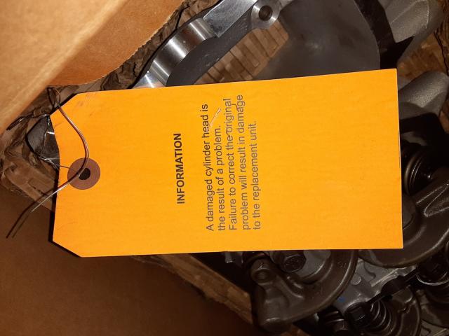

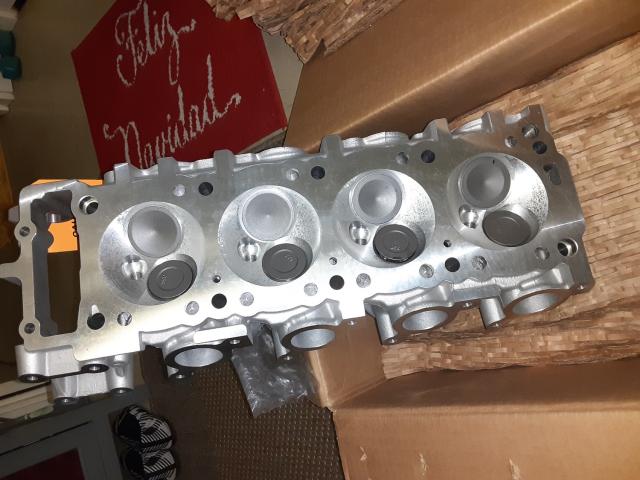

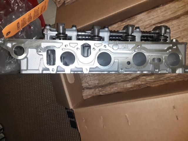

    OK, I brought the head back up to my penthouse (ha) and did an inspection; it looks clean no metal shavings, the rear cam seal is not installed (that seal is listed in the contents of the head gasket set, hope no special tools or supplies are needed to install it, hope Vernon knows how to install it..?) the valve train is hydraulic like I wanted, new valves, new valve stem seals, new valve springs, the cam has a few scratches all around each lobe, hope the cam lasts many miles [should a new cam have scratches..?] I think not but it's not a racing engine... the head looks to be the correct part ~ not sure if any bolts have been torqued to spec (probably?) it came with 26 threaded studs for the 26 threaded holes in the head; I threaded one stud into the head and it went in easily by hand (the short thread end of stud)
    Anyway FMS the melt tabs appear to be nothing more than purple colored temp stick markings much like the ones we used as welders; there is one mark on each end of the head front & back a purple color ~ if the head overheats the range of the temp marking then those marks with either melt off or change color which voids the five year unlimited miles warranty...
    I should do a YouTube review of "M28 cylinder head" ~ think I saw a Starion M59 head video that basically shows the improvements over the original stock head (more/bigger water jackets, jet valves, etc., blah, blah..?)
    So here are some photos: (please forgive if too large or too small...)
    1,589

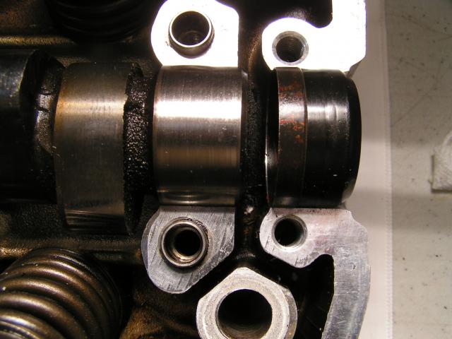

    THE HEAD ASSY I RECEIVED HAS SEVERAL VERY NOTICEABLE SCRATCHES ALL AROUND EACH CAM LOBE SURFACE

    My thoughts on the camshaft scratches:
    IMHO there should not be any scratches on a new piece of polished & machined & lubricated surface, none of the other parts have scratches ~ I once bought and installed an Iskadarian (sp?) 3/4 race cam into the 272 cu in Ford V8 engine of my 1955 Ford Fairlane 2dr sedan and there were no scratches on those lobes...

    Thanks for the pic of the Melt Tab. Makes sense to attach it to the freeze plug on the rear of the head. The head looks good and wise of you to look it over very carefully. It's hard to say if the scratches on the lobes are an issue, but Vernon should be able to give his opinion. He can also examine the original cam and help decide if using the original is the better choice. Personally, I wouldn't hesitate to use the original if it's in good shape and the scratches on the new cam are severe. I've also read that the stock cams are metallurgically superior to aftermarket cams.

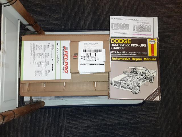

    1) I will check my FELPRO head gasket to ensure it has joined fire rings on at least one side...
    2) Should (for ease) the intake manifold stay bolted to the head until the assembly is removed from the engine compartment..?

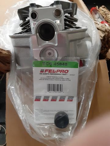

    3) Do I need to use any sealer or gasket spray anywhere besides IF reusing the old camshaft plug..?

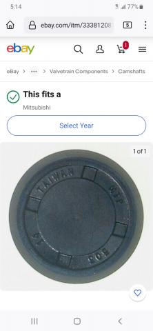

    4) O'Reilly's had the camshaft plug $6.00 total shipped from mainland arrives 12/28 and ebay seller not willing to ship to Hawaii... Thanks to FMS88 I was able to show O'Reilly's which plug matched this photo...

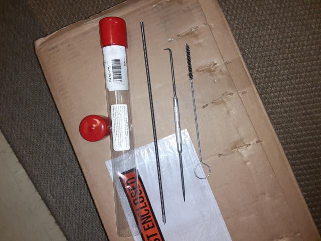

    5) Per FMS88 tips, I bought the fingertip covers to use as valve lifter holders (for removing rockers/cam from head)

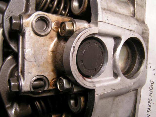

    First a correction to my earlier post: It isn't possible to remove only the rear cam tower to install the cam plug. You have to loosen considerably all cam tower bolts. So might be just as well to loosen them until free, install the finger tip lifter retainers and then lift off the towers and rocker assembly all together. Then you can easily inspect the cam lobes.
    The finger cots should work but they're latex which doesn't resist oil as well as nitrile. As Subgothius suggested in another post, just cut the finger tips off some disposable nitrile-rubber gloves.

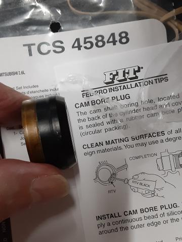

    Question #1. I have a stock head gasket that looks like Santa's. Not certain about the Fel-pro, but I bet it does too.
    #2. You're right, a couple intake manifold nuts are hard to reach. Removing and installing the head and manifold together is a solution, but they can be a bit unwieldy and heavy.

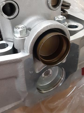

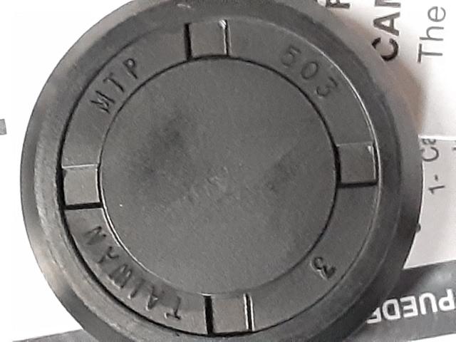

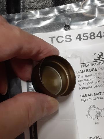

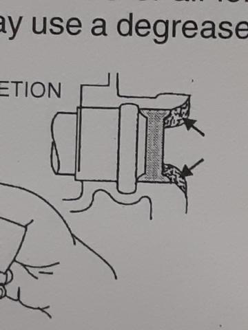

    #3. If you get a new plug, gasket sealer is optional. The plug has a coating that compresses and seals so additional sealer isn't necessary. If using the old plug, sealer is recommended. I use Permatex, but a little RTV will work too.
    #4. When installing the plug align it's open edge with the edge of its bore in the head. This should leave a gap of 1/4 to 3/8" between the plug and the end of the cam as in the photo below:
    After the installation of the cam tower, the plug looks like this:
    With the rocker assembly removed, check and clean the bottoms of the bolt holes for metal shavings. I found a fair amount of them in each hole on my head.
    Other than the cam plug, the only other places to apply sealer are where the top of the timing chain case and block meet (apply it before placing the head gasket on the block); to the contact surfaces of the semi-circular plug; and the inside corners of the rear cam tower. Do the latter two applications when installing the valve cover. Those are the only places I can think of at the moment.

    O'Reilly's received the rear cam plug ($6.00 total shipped, great deal) & guessing it goes in rubber side in first ??? As shown in these photos...
    07-23-2018
    504
    Seattle, WA
    1988 Dodge Power Ram 50
    Six bucks is a good price.

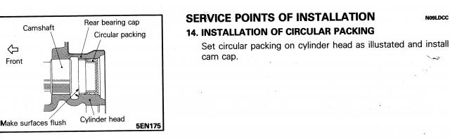

    Here's the FSM installation step for the circular packing:
    The open end is installed toward the cam if the cam tower/cap was removed and is now being installed. I think Fel-Pro wants the plug in the opposite direction because they're assuming you haven't removed the cam tower and will be driving it into opening. With the open end to the rear and the chamfered end toward the cam, it should be much like installing a freeze plug. I've always installed the plug after removing the cam towers, but I think the Fel-Pro directions will work too if you leave the cam tower in place.
    Whichever approach your take, apply a little sealer to the inner third of the packing. Notice that it has a slightly smaller diameter than the other front and rear thirds. That and the coating on the plug should create a good seal. Fel-Pro's instruction to apply RTV around the outer edge of the plug is for extra measure.

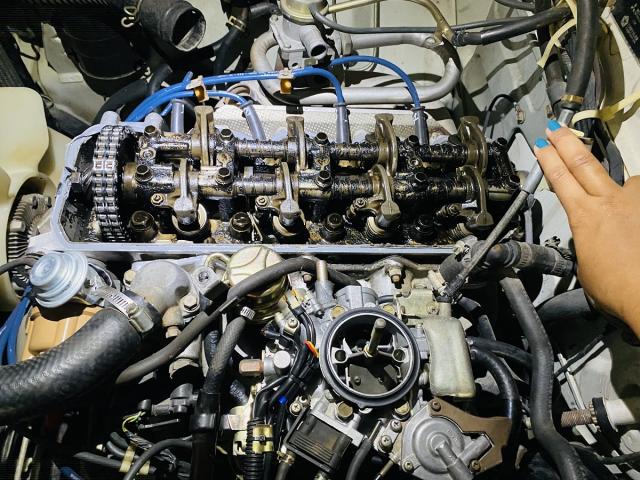

    My only engine photo showing the valve train, only the fuel pump cam lobe is showing..! The photo proves my engine has a hydraulic valve train; 135,800 miles now... I better measure Chinese cam journals compared to my existing cam (size matters..?)

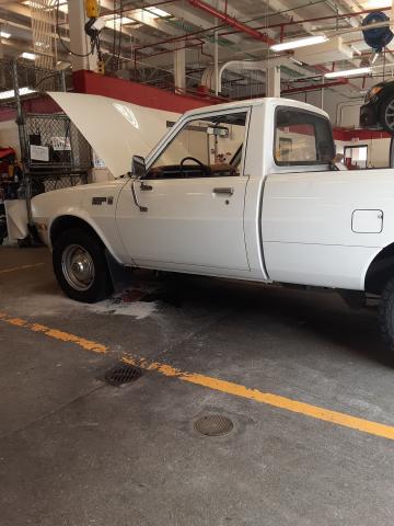

    I hit the MR50 20 photos per day upload limit so just wait more photos are coming... Yes we did add a pint of zinc additive but I only kept the old camshaft all else was tossed in a metal recycling container... Kevin West said: "because the truck is not being raced and that because I asked for a hydraulic valve train, the rocker arms he sent are NOT Chinese and he recommended keeping the old cam and the Chinese cam is included in the 5 year unlimited miles warranty" (providing the temperature marks do not indicate the head overheated which voids the warranty...)
    Kevin's remarks, my laziness & time constrains, cost of the work stalls and excessive wear on the old valve train helped me to make the command decision to install the complete head as sent to me from Clearwater and avoid learning anything new :^)
    I'm glad the carburetor, fuel pump & fuel hoses were previously replaced which gave me the confidence to just tie them back out of the way and not disassemble the rats nest ~ both manifolds were tied back too + I had two US Marines that helped me remove & install the cylinder heads..! Got the job done in less than three full days ;^)
    The engine feels more snappy & well connected to the accelerator it especially has a stronger compression braking when letting off the gas pedal (no extra horsepower in the butt-o-meter tho)... I tossed the old rocker/lifter valve train as it was well worn only 3 lifters looked ok the others way worn...
    There is sometimes an intermittent engine miss not always the same, slight lack of power at low RPM or an actual slight bucking feel miss when accelerating & sometimes no miss at all... The engine idles rougher than before but the idle came down some when setting ignition timing (a good thing) I am certain the carburetor needs air fuel needle and other adjustments (the California tamper plug is still in the carburetor body) and since I bored out the carbon in the intake manifold EGR passage from the head towards the carb 'n EGR valve there may be carbon crud up against the EGR (I need to remove clean inspect the EGR...) I got my 1st of two shingles vaccinations yesterday & am taking Tylenol to fight the flu like chills 'n body aches... Will now try uploading a few more photos in my Clearwater photo album...
    Many thanks to FMS88 and geezer too and everyone who offered me advice & motivation to get er done..!
    A few photos before leaving:
