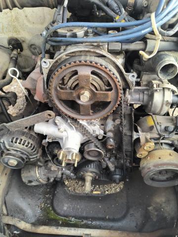

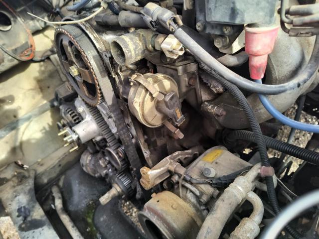

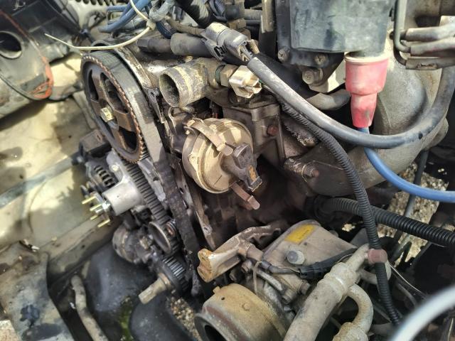

    So I got it all the marks lined up again. Here are the photos. I'm pretty certain the distro was pointing at my number four plug. I followed the line after taking it off. So would I reassemble it all and just flip my plug wires? How do I reset the distro? I know to take it out and line the dimple up.

    I lined it all up and tried to reset the distro again. But if I line the dimple up and try to slide it all in it won't line up with the stud, and instead will twist itself like a quarter turn and lock itself into place. But it won't go in smoothly at all. It has to rotate.

    got to post #11. i posted pictures of how everything will look when its all times

    Quote Originally Posted by BillHilly View Post
    That's how it works. When you insert the distributor gear, it will cause the shaft to rotate into position. The rotor should be pointing to the leading edge of #1 post in the distributor cap if you've installed it correctly.
